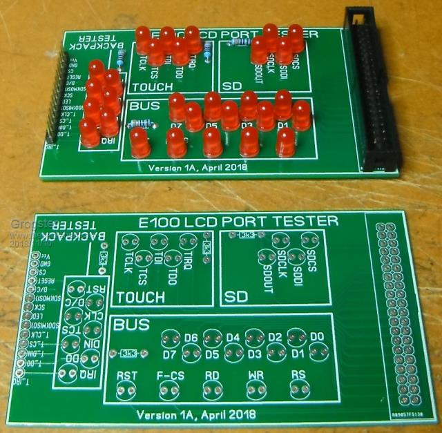

Posts: 10043
Posted: 09:11am 10 Nov 2018
I also have a tester PCB available, for those who are curious if their port pins are working correctly. Third from the bottom of the page. Tests both the parallel and the SPI based MM boards.
MMBASIC code to use the tester is available from my downloads page.
PCB only. You need to supply the components.
