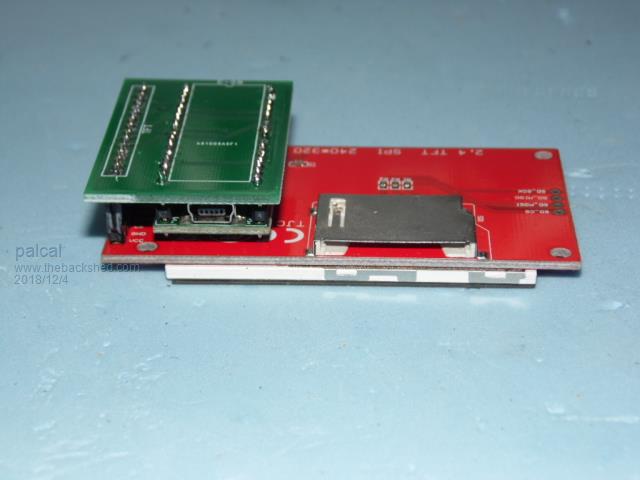

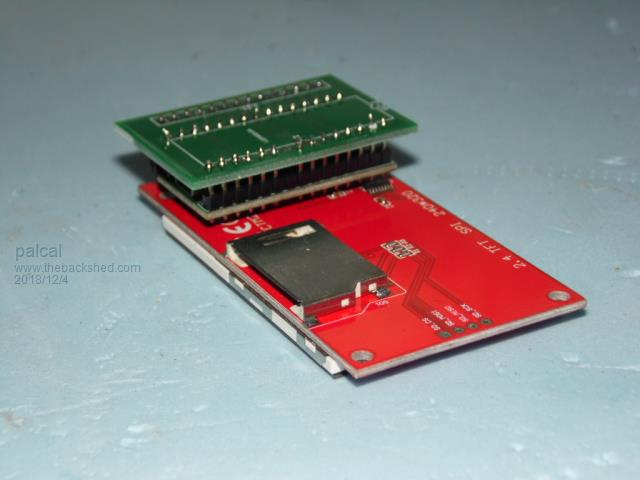

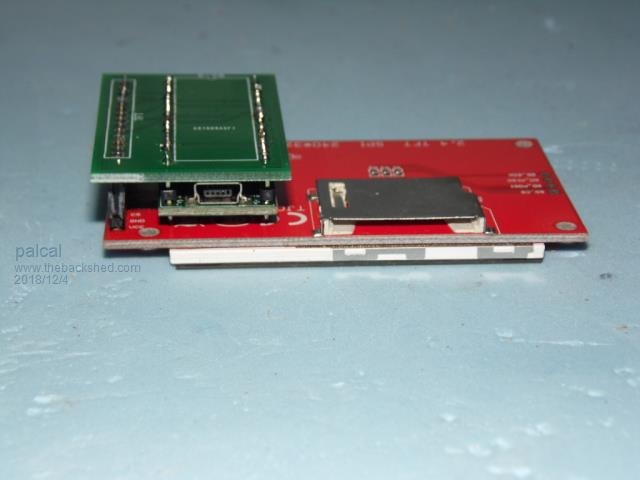

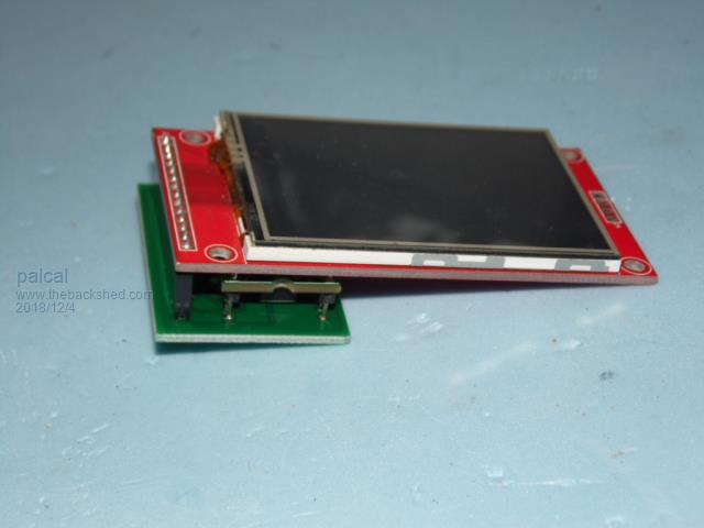

I had a project I wanted to make as small as possible, so designed a carrier board to attach a display to an E-28. I have some boards if you want one. See pics.
It does make the sandwich 3 high though. 20mm. thickEdited by palcal 2018-12-05

Thats a neat (and useful) little board you have there!
Height not too much by the look of things.
I have a 3D printed enclosure that is a perfect fit for BigMiks SMD BP, just need to either edit the 3D file to move the USB socket hole; or persuade Mik to update his module to replace the FTDI with a PIC1454/5.
I may well contact you regarding one of your PCBs though if you don't mind

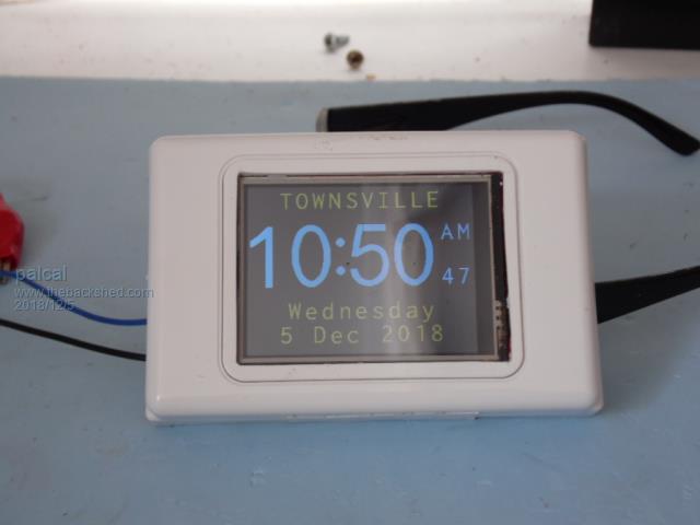

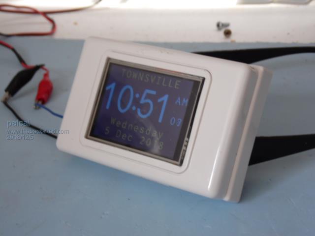

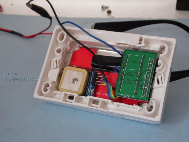

While on the subject of enclosures for projects, this is another great idea but it is NOT mine, I think I saw it in a post from TassyJim ( put your hand up Jim if you are responsible). It is a blank wall plate with a cut out for the display. I have mounted this one on a low profile mounting block. The mounting block has been butchered to fit everything in. It's not finished yet, a friend wanted an accurate clock for his office.
The pictures are not the best.
Edited by palcal 2018-12-06
Posts: 6606
Posted: 02:08am 05 Dec 2018
  palcal said  I think I saw it in a post from TassyJim ( put your hand up Jim if you are responsible).
Yes, that's my patented procedure.
They are a tight fit!

What exactly is a "low profile mounting block"--I don't recognize it from the back view--maybe it's not common or not available in the U.S.
palcal
Joined: 12/10/2011
Posts: 2052
Posted: 07:48pm 05 Dec 2018
@ Lizby
Here in Oz and I would suspect in the US as well you have power outlets on the wall, usually integrated into the dry wall. If it is not possible to mount into the wall and the outlet has to be surface mounted you can get mounting blocks for the power outlet.
They mount onto the brickwork or whatever and so you have an enclosure for the outlet.
The normal mounting block is about 30mm deep but here anyway you can get the low profile ones.
