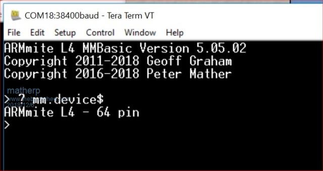

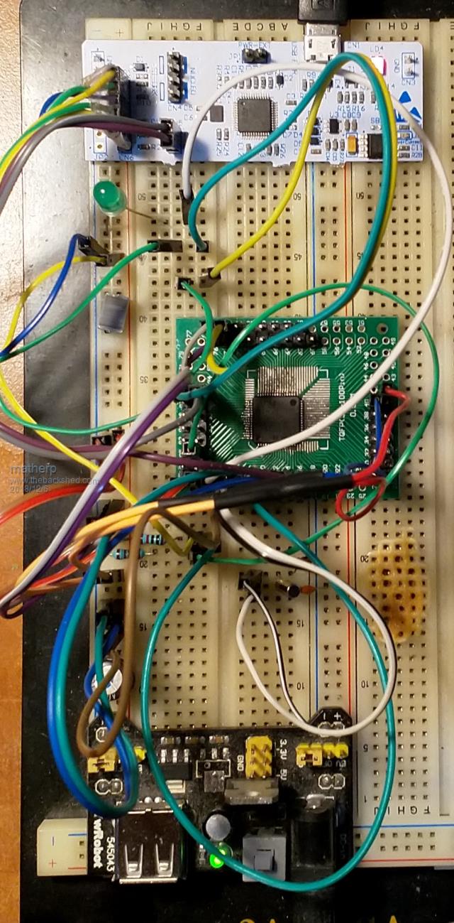

Please find attached version 5.05.02. This now includes support for 64 pin variants, the STM32L433RCT6 and the STM32L431RCT6 as well as 48 pin and 32 pin. The software automatically configures for the number of pins. I've done the development on a STM32L431RCT6 on a breakout (pic below) but the code should run well on a NUCLEO-L433RC. With all the STM32L4 the mandatory connections are:
all VSS and VCC including VSSA and VDDA, each pair decoupled close to the chip with 0.1uF ceramic caps
BOOT0 10K to GND
NRST 10K to VCC and direct to ST-LINK
Console TX and RX to USB/UART (or ST-LINK)
SWDIO and SWCLK to ST-LINK for programming
32KHz crystal to OSC32-IN and OSC32-OUT with 6pF caps to GND - NB this is essential for the firmware to run
VBAT (N/A for 32-pin) to VCC or to 3V battery
