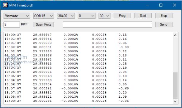

3 years ago I presented MMTimeLord as an aid to calibrating micromites.
I have added a few more options to allow it to be used for calibrating Armite RTCs as well as testing all the other devices we now have.
Back in Jan 2016, we discovered that FTDI USB adapters didn't have consistent timing. They still don't and nor does the microbridge. The timing can be up to 15mS out at any given time.
CH340 adapters are good and so are the Armite NUCLEU devices.
2018-12-07_144216_MMTimeLord.zip
The ZIP contains a manual and sample spreadsheet.

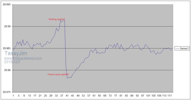

The frequency fluctuations on the micromite are obvious here. First, a finger on the chip to heat it up then zapped with some freeze spray.
