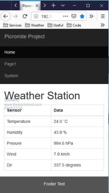

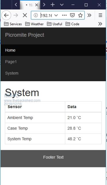

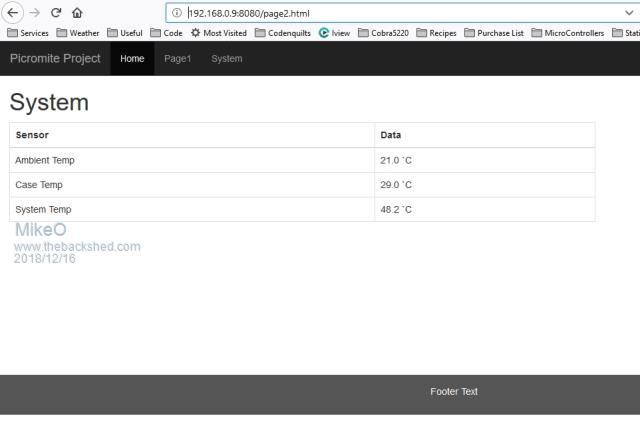

Have been experimenting with a web user interface for picromite projects. It is envisaged it would be used for data display, administration etc.
The Picromite code is based on Peter's original web code and the Web pages uses the "Bootstrap" framework. Not all of framework will work on the mmbasic/picromite due to its simple web server but much of it does and it is possible to build a nice responsive interface which works on PCs thru cell phones.
Web Interface files here 2018-12-16_141905_BS.zip
