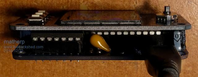

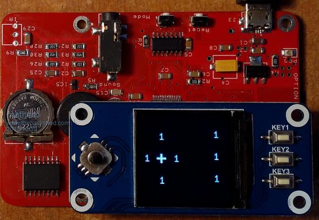

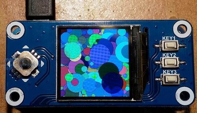

Search for Waveshare 1.3" LCD HAT. I bought it here.
The display is 240x240 pixels and uses IPS technology to give a crystal clear image.
Loadable drivers below for the MM2 and MM+. The MM+ driver supports image load as well as the usual drawing commands. The pins in the example files support my HAT stand PCBs as pictured. Syntax is:
ST7789 DCpin, RESETpin, CSpin, orientation '(1=landscape, 2=portrait, 2=reverse landscape, 4=reverse portrait)
and of course the driver and MM.STARTUP should be stored in the library.
The pins on the pi header are 19=MOSI, 23=CLK, 22=DC, 13=RESET, 24=CS, 40=KEY1, 38=KEY2, 36=KEY3, 31=UP, 37=RIGHT, 29=LEFT, 35=DOWN, 33=PUSH. Corresponding MM pins on my HAT STAND PCBs are in the listings. I'll post an update for the Pi-cromite to support this display in a separate thread. In future, this display will also be supported on the MMX and Armmite L4.
MM2
Sub mm.startup
Dim integer right=23, up=15, down=6 ' Left and push are reserved pins on Mircomite HAT stand for MM2
Dim integer key1=26,key2=24, key3=7
ST7789 2,16,9, 1 ' landscape is natural orientation for display
End Sub

Very interesting.
I note that this little module also has three tact buttons and what appears to be a SMD type of rotary encoder on the left. Or perhaps a four-way-with-OK button thing.
The listings for this module don't seem to state where these buttons and encoder are connected to. I expect they connect to the pins on the GPIO connector somewhere.
EDIT: I see that it is a 4-with-OK switch thing on the left, and your code gives us the numbers. I might have to get one of these to play with. $16 in NZ money - not bad considering you get the extra tact buttons.Edited by Grogster 2019-01-01

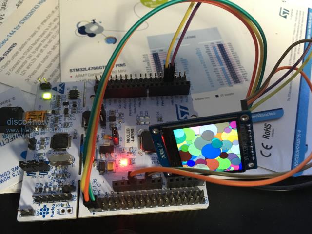

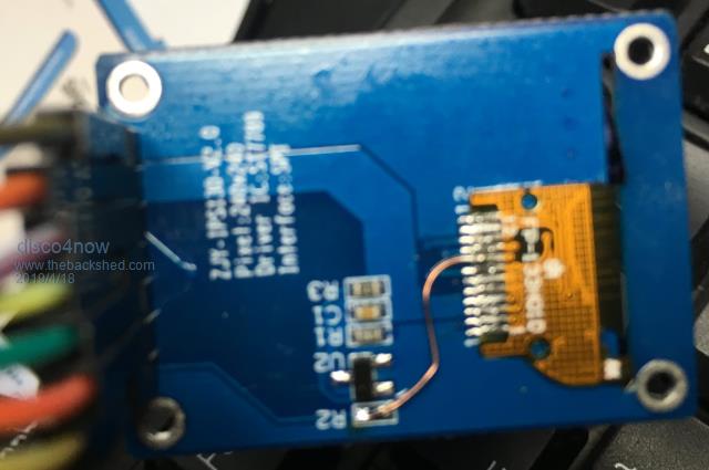

I have a couple of these ST7789 clones that come without the CS pin exposed. I have the source for Peter's driver for the MM2 and MM+ but have not been able to get it to go as is i.e. with CS permanently selected on the board. Apparently when they work with Arduino, they use SPI mode 3 but I have no success. In the end I modified it to expose the CS pin in lieu of the BLK pin that is not really required. It works with Peter's drivers for MM2 and MM+ and natively supported on the ARMMites.
Here is my modification:
1. Remove R2 (Disconnects BLK pin)
2. Pin 8 of the ribbon is CS, it is connected to GND on the PCB but under the ribbon.
I used a heat gun and lifted the ribbon, then cut the track at the base of pin 8 on the PCB, checking it was no longer connected to ground.
3. Put the ribbon back
4. Run a small wire from pin 8 to the R2 pad that goes to the BLK pin.
5. BLK is now gone and is now CS.
6. A few sprays of circuit board lacquer to glue it all down.
When I modified my second one, I straighten a paper clip and slid it under the ribbon to apply a bit on tension during desoldering. I think just using a soldering iron on top with a bit of tension would get it to release. I used a very small drill, just held with fingers to remove the copper at the end of pin 8.I think there was a small via there. I am 2 for 2 success rate now, so it is doable.
The original post with this information. I had trouble locating it again so have reproduced it here.
The summary on the Fruit of the Shed has been updated for this display.
LCD Summary on Fruit of the Shed
