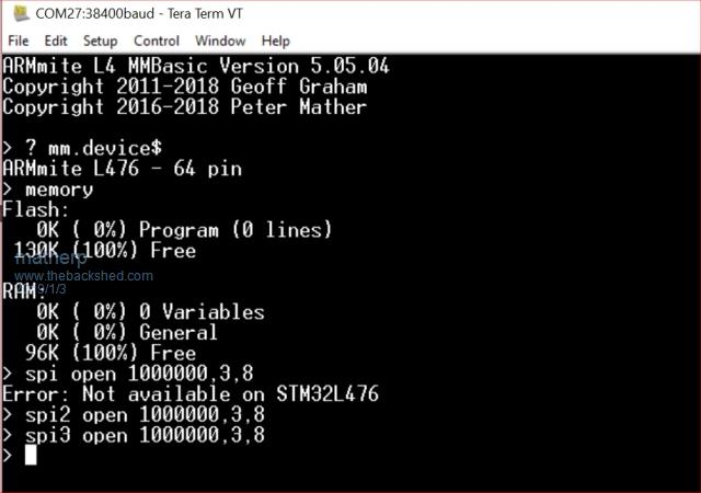

Some problems with the L476 - I am using an Arduino shield with the Winbond 25Q32 on it wired as per your instructions. I have wired D8 on the shield as the 25Q32 chip select line. So, starting up ...
> ARMmite L4 MMBasic Version 5.05.04
Copyright 2011-2018 Geoff Graham
Copyright 2016-2018 Peter Mather
> print mm.device$
ARMmite L476 - 64 pin
> print mm.ver
5.0504
> option vcc pin(vdda)
> print pin(bat)
3.302277252
> print pin(temp)
16
... all OK so far.
Now I want to use pin D8 as the chip select for the 25Q32 so I test it first -
> setpin D8,dout
Error: Pin 0 is invalid
... as pin D8 is on pin 42 of the STM
> setpin 42,dout
> pin(42) = 0
... measured 0 on pin 42 / D8
> pin(42) = 1
... measured 3.3V on pin 42 / D8 so pin 42 is D8 and works.
Now I try to set up the flash
> Option flash D8
> Option flash 42
Compatible flash memory not found
... so,
I have double checked the wiring to the 25Q32 and it is as follows
Pin 1 : Chip select, connect to any free pin on the uP - I am using D8
Pin 2 : SPI data out, connect to SPI2-IN (D12) on the uP
Pin 3 : _Write enable, connect to GND
pin 4 : GND, connect to GND
pin 5 : SPI data in, connect to SPI2-OUT (D11) on the uP
pin 6 : SPI clock, connect to SPI2-CLK (D13) on the uP
pin 7 : RESET, connect to RST on the uP
pin 8 : VCC, connect to 3.3V
Any suggestions as to where I am going wrong?
Doug.
NB. The Arduino numbering does not work on the L432 either. D.
Disregard - dopey Doug - of course it does not work on the L432 - there is no Arduino connector there!!!

Posts: 11881
Posted: 08:41am 05 Jan 2019
The Arduino nomenclature is supported on the 432 but not (yet?) on the 476 - just use normal pin numbers. See the pinout details at the end of the first page of this thread for details.
{ GPIOB, GPIO_PIN_3, DIGITAL_IN | DIGITAL_OUT , NULL, 0}, // pin 55 SPI2-CLK
{ GPIOB, GPIO_PIN_4, DIGITAL_IN | DIGITAL_OUT , NULL, 0},// pin 56 SPI2-IN
{ GPIOB, GPIO_PIN_5, DIGITAL_IN | DIGITAL_OUT , NULL, 0},// pin 57 SPI2-OUT
Edited by matherp 2019-01-06
Posts: 11881
Posted: 10:39am 05 Jan 2019
This minor update allows you to use the Arduino nomenclature for pins on the NUCLEO-L476RG or NUCLEO-L433RC, e.g.
SETPIN A1,AIN
SETPIN D2,DOUT
PIN(D2)=1
PRINT PIN(A1)
2019-01-05_203903_ArmmiteL4.zip
Note: the special functions assigned to the pins do not map the silkscreening on the Nucleo - see table below. Also D0 and D1 are the console pins so cannot be used for normal I/O
