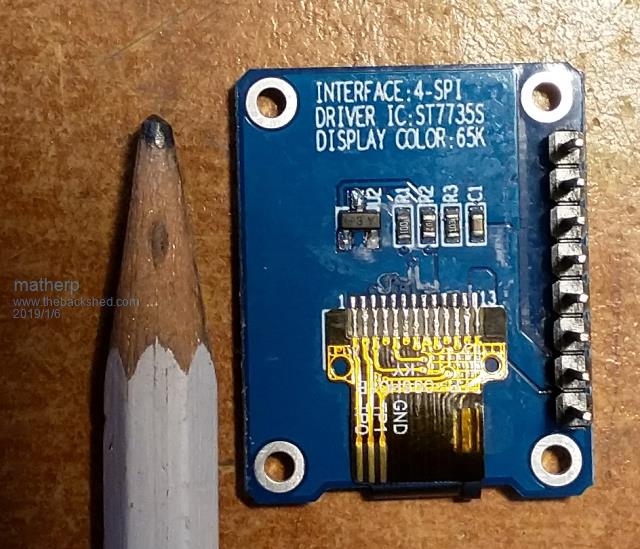

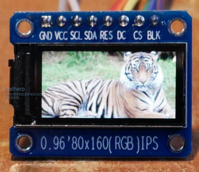

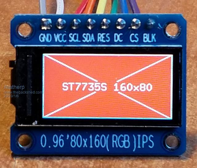

Just £2.81!
I've been looking for small low power displays for the Armmite L4 and came across this. Ideal for adding a "small" (pencil for scale) touch of colour rather than the SSD1306 etc.
Loadable drivers for the MM2 and MM+ below. MM+ supports image load.
MM2
Sub mm.startup
Dim integer right=23, up=15, down=6 ' Left and push are reserved pins on Mircomite HAT stand for MM2
Dim integer key1=26,key2=24, key3=7
ST7735S 2,16,9, 1 'DCpin, RESETpin, CSpin, orientation (1-4)
End Sub

MM+
Sub mm.startup
Dim integer right=49,up=52, down=45, PUSH=42, LEFT=23
Dim integer key1=58, key2=8, key3=46
ST7735S 64,16,62, 1 'DCpin, RESETpin, CSpin, orientation (1-4)
End Sub

Hi Peter,
Two main questions if I may:
1> What is the BLK pin for? Backlight?
2> Is the display's viewing angle any good? (or do the colours 'wash out? If compared to OLED RGB, is this IPS TFT comparable?
Posts: 11881
Posted: 07:00pm 06 Jan 2019
  Quote  What is the BLK pin for? Backlight?
Yes
  Quote  Is the display's viewing angle any good?
Same as any other IPS display, very clear and bright
  Quote  If compared to OLED RGB, is this IPS TFT comparable?
No - it is 1/10th of the price

THIS IS WITH ORIGINAL CODE. Your post came in during my tests!
Starting at Orientation 1: Blank on Reset. Left and Top Box lines only. Offset down and to the right
Orientation 2: Now only a white dot in lower left corner ? Box: Left and bottom lines only.
Orientation 3: white dot in each of bottom corners. Box: Bottom and Right lines only
Orientation 4: white dot in two right corners. Box: Right and Top lines only
NOTE: These tests were carried out with the code in Program Memory, and not the LIBRARY. Edited Orientation value, F1, Reset (Rst pin to GND), then observed, and did the BOX command.Edited by WhiteWizzard 2019-01-10
