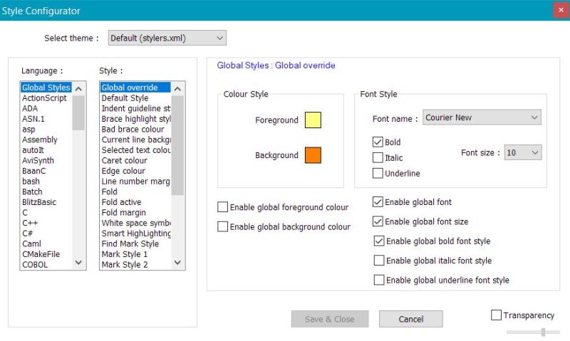

2: I use a White background - lot of people use Black or other dark colours:
The simple way to try out my colour syntax scheme is to:
Goto Settings -> Style Configurator then select Global override, from the list-box labelled Style:
In Colour Style box: Set Background colour style to White.
Below that Tick Enable Global background colour.
In Font Style: Tick Bold, Set Font Name to Courier New, Font size to around 10.
Below that Tick:
Enable global font
Enable global font size
Enable global bold font style
All other boxes are not ticked.
NOTE: If the above does not work then you may need to edit Default Style and change FG colours to Black and BG colour to White. In this case un-tick only the Enable Global background tick box from the above settings.

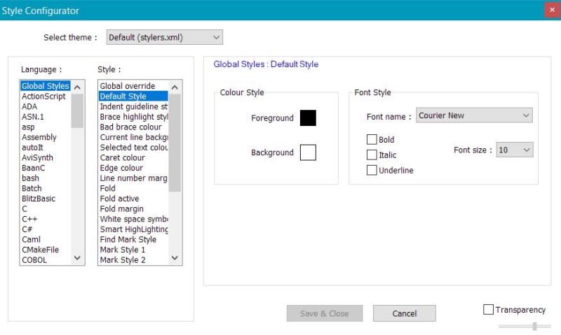

This has the full ready to go package, just click run notepad++.exe.
The default background was already set to WHITE and foreground to BLACK.
Below are the screen shots of the ONLY changes I made:
Copy the userDefineLang.xml file I will supply into the main directory, that's the same directory as notepad++.exe.

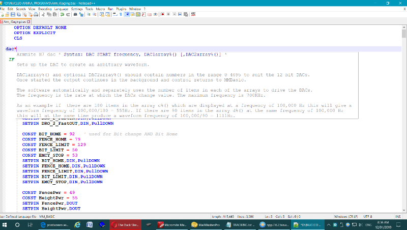

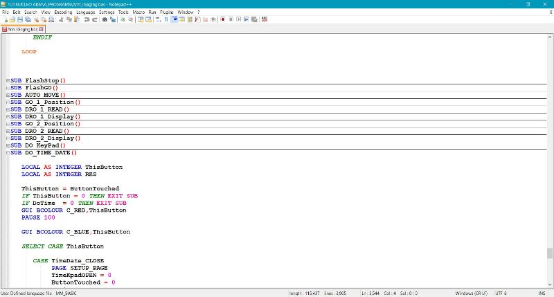

This shows Syntax highlighting and Functions and Procedures folded:
Auto Syntax as I type, I can scroll down the alphabetical sorted list.
Below:
I've set the * character to bring up Full Usage syntax for the Commands,
This can be changed but there is a reason why I chose to do this, and it all has to do with the constraints imposed by NP++ and the xml file.
Showing DAC usage pop up. The pop up is partly transparent but it shows up to a full screen of information and is very easy to read compared to the picture below.

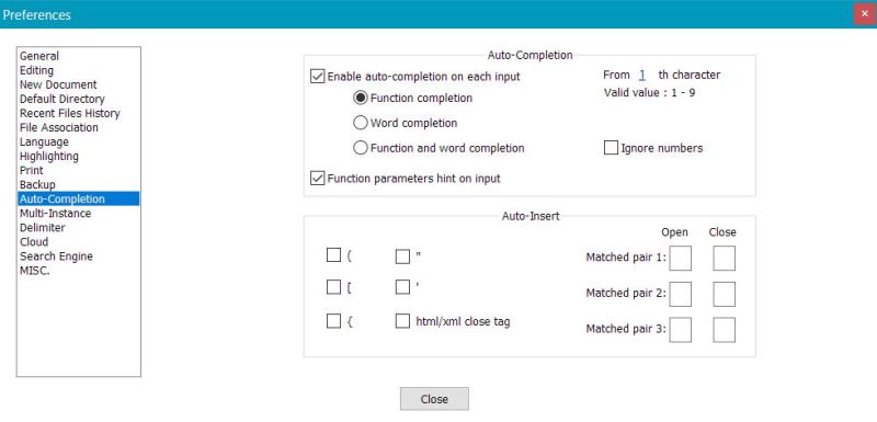

A few thing about Auto Complete and why I used * to highlight command usage.
As you type, if the first char you type matches the first char in a keyword in the Auto complete file, then it will open the Auto complete scroll window and the first keyword starting with the char will be shown in an alphabetically sorted list.
As you continue to type it's narrowed down, if you press ENTER then the keyword will be inserted into the edit window.
Once a keyword is in the editor, if typed it in completely or you pressed enter, then normally you would enter and opening left bracket "(" and this is the default function hint character. Typing this Char causes the command Hint window to open.
When you do that the Syntax and information is displayed in another pop up window. The problem is that I want to show the many MM.Basic procedure information, and using the "(" is confusing. The normally selected Function start and close char's "( )" are automatically placed after keyword name and surround the command usage and no way to overcome this, so I chose "*" as the function start and end chars, this makes a world of difference to me anyway and allows me to use the built in Function Hint for every MM.Basic keyword.
For some simple functions and procedures there is no need for an extra Hint action or window description as I found a way to include the full command usage after the keyword. In this case, only the Auto complete window is needed and no Hint is made available.
Like I said - trying to work within the limitation imposed, I'm getting close to having almost every function, procedure and command word fot the Micromite, MM+ and ARMmite H7 in my auto complete file.
The file is simple to edit in Notepad++ itself, so you can simply change it to meet you needs.
I'll place a link to them as soon as I'm happy with them, likely in the next week unless someone has already made one and beats me to it.
Mike.
