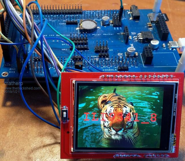

Would it be possible to add the LCDpanel ILI9341 320 x 200 in 8 bit mode. The current micromite ARM H7 firmware supports 16 bit, but not 8 bit, I believe??

  Quote  Would it be possible to add the LCDpanel ILI9341 320 x 200 in 8 bit mode. The current micromite ARM H7 firmware supports 16 bit, but not 8 bit, I believe??
I could but if you are thinking you could use one of the Arduino format display PCBs to plug into the Nucleo header then that wouldn't work as I use a completely different pinout. Also, I allocate all 16 pins on the port even if you are using an 8-bit driver (e.g.SSD1963) so it wouldn't free up any pins.Edited by matherp 2019-01-20

  Quote  Adding the 8 bit option must be too difficult or too time consuming for you.
No, its trivial other than testing but I'm trying to understand what you are trying to achieve. It doesn't free up any H7 pins, it doesn't impact SPI5, it just runs slower. The only ILI9341 displays in 8-bit mode I'm aware of are in Arduino format, are incompatible with the Nucleo Arduino header and don't have a touch controller so it just seems like make-work unless you can explain differently

Posts: 11881
Posted: 03:59pm 20 Jan 2019
OK then
2019-01-21_015216_Armmite1.3.zip
2019-01-21_015833_Armmite_H7_Manual.pdf
OPTION LCDPANEL ILI9341_8, orientation
Selects 8-bit bus operation of the ILI9341 display. Pin usage is exactly as per the SSD1963. Pins SSD1963_DB8 to SSD1963_D15 are allocated but not used. Uses a memory resident framebuffer to improve performance.

Posts: 11881
Posted: 01:49pm 21 Jan 2019
  Quote  Will let you know should any bugs appear.
Shouldn't be bugs in the driver as just a clone of others
