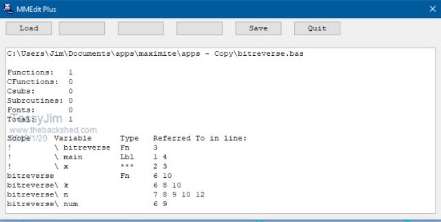

MMEditPLus is a stand-alone variable report producer.
It will eventually replace the one built-in to MMEdit but for now it can be used with Notepad++
It does differentiate between variables local to functions and should flag any undeclared variables.
To run from Notepad++
Go to Run/Run
Navigate to MMEditPLus.exe and add "$(FULL_CURRENT_PATH)"
after the end of the file name. Include a space and the quotes.
Your shortcuts.xml file should now have an entry similar to:
<Command name="Variable Report" Ctrl="no" Alt="yes" Shift="no" Key="119">C:\apps\PBprojects\variableReport\MMEditPlus.exe & quot;$(FULL_CURRENT_PATH)& quot;</Command>
I had to put a space before 'quot' in the above to stop the forum interpreting it.
I set alt-F8 as the shortcut key.
To send the current file to the variable report,
Save then Alt-F8
MMEditPlus can be open or shutdown. It will replace any existing report with one for the current file.
I haven't found a way to automate the save before run part (yet)
If you drag and drop a filename, drop it in the area above the text frame.
You can drop selected text directly into the text frame and it will be scanned.
With MMEditPlus open, ctrl_A to highlight all the text in Notepad++ or MMEdit and drag it across to MMEditPLus.
This allows you to check code without saving first.

2019-01-20_120326_MMEditPlus.zip
It is many times faster than the builtin version and does more including sorting.

Hi Jim,
Looks good.
A minor issue easily worked around , the variables M1H,M1L,M2H and M2L in the expression below are not picked up as declared.Could be because of the assignment before them.
  Quote   DIM FLOAT M1=(R1+R2)/R2,M1H,M1L,M2H,M2L
Gerry
F4 H7FotSF4xGT
Posts: 6606
Posted: 05:43am 20 Jan 2019
  Chopperp said
Noticed that the subroutines come up as "Fn" in the "Type" column in the program I'm testing at the moment
I didn't differentiate between subs and functions.
I also didn't differentiate between const and dim.
For the exercise of tracking variables, the differences don't matter.

Did find one thing, the line below is in SUB OpenJOBS()"
Open "JOBS.TXT" For RANDOM AS #3
In the Listing:
OpenJOBS \ RANDOM *** 2945
EDIT same for OUTPUT:
Open "SETTINGS.TXT" For OUTPUT AS #2
SaveSetup \ OUTPUT *** 2827
I assume it thinks these are not declared.
Mike.
Edited by KeepIS 2019-01-21
NANO:Inverter V 8.4ksLinux AvrDude GUI script V4.1
Posts: 6606
Posted: 06:34am 20 Jan 2019
I missed RANDOM from the keyword list.
Will fix.
I also had a bug when there are 2 spaces between FUNCTION and the name of the function.
That will also be fixed in the next update.
I have a few ideas to speed up the processing but it needs careful thought.
Time to open a bottle of thought juice.
2019-01-20_165921_MMEditPlus.zip
Double spacing shouldn't cause problems and RANDOM has been added as a keyword.
Edited by TassyJim 2019-01-21
