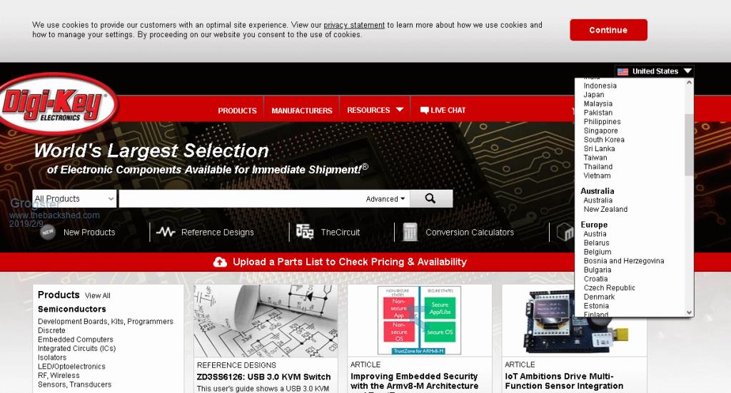

Posts: 10042
Posted: 07:26am 09 Feb 2019
Well, DigiKey list New Zealand as part of Australia - so whaddya think of that?!
