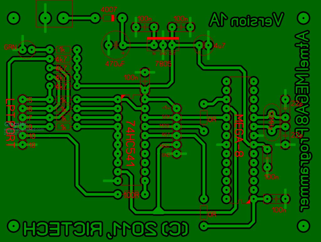

EDIT: I found the PCB pattern for the MEGA8 programmer from eight years ago:
This was single-layer, and eight years ago, so it is not as neat as my recent designs.
It obviously worked from the printer port. I have no idea now what application that would have been, but I suspect it was a 3rd party programmer and software. I would not have designed this circuit, I would have found it on the net and just done the layout for it.
I wonder what LPT software programmer I would have been using?
Anyone got any ideas?Edited by Grogster 2019-03-17

Oh, that's quite old.
You could program the ATMEGAs via a PC's parallel port - back when there was one.
Now you'd probably use a USBASP like this because USB is quite widespread. And they cost about $1.
I tend to use avrdude as the program talking to the usbasp. (You can do it via the Arduino IDE if you like but I tend to use it without the IDE.)
