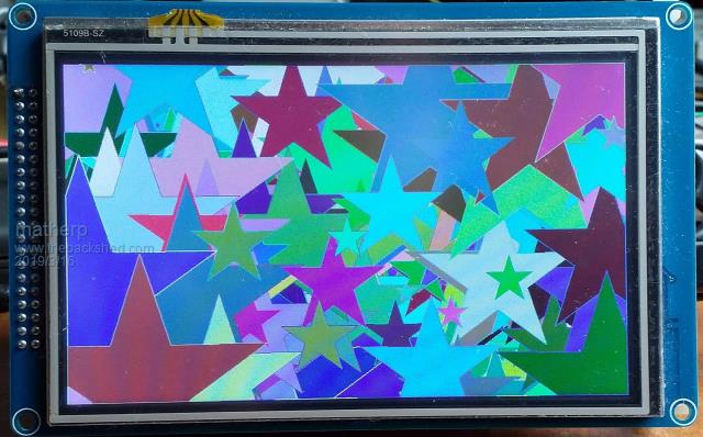

POLYGON xarray%(), yarray%() [, bordercolour] [, fillcolour]
Draws a outline or filled polygon defined by the x,y coordinate pairs in xarray%() and yarray%(). If fill colour is omitted then just the polygon outline is drawn. If bordercolour is omitted then it will default to the current gui foreground colour. The polygon should be closed with the first and last elements the same. The size of the array must exactly match the number of x,y coordinate pairs.
See the video of the example code running on the Armmite H7. The MMX is slower but still very usable.
option explicit
option default none
dim x%(9),xd%(9)
dim y%(9),yd%(9)
dim integer i,c,f, xp, yp
dim float s
cls
for i=0 to 9 step 2
x%(i)=-(SIN(rad(i*36))*200)
y%(i)=-(COS(rad(i*36))*200)
x%(i+1)=-(SIN(rad((i+1)*36))*76)
y%(i+1)=-(COS(rad((i+1)*36))*76)
next i
do
c=rnd()*255 + ((rnd()* 255)<<8) + ((rnd()* 255)<<16)
f=rnd()*255 + ((rnd()* 255)<<8) + ((rnd()* 255)<<16)
xp=rnd()*mm.hres
yp=rnd()*mm.vres
s=rnd()
for i=0 to 9
xd%(i)=x%(i)*s+xp
yd%(i)=y%(i)*s+yp
next i
polygon xd%(), yd%(), c, f
loop
