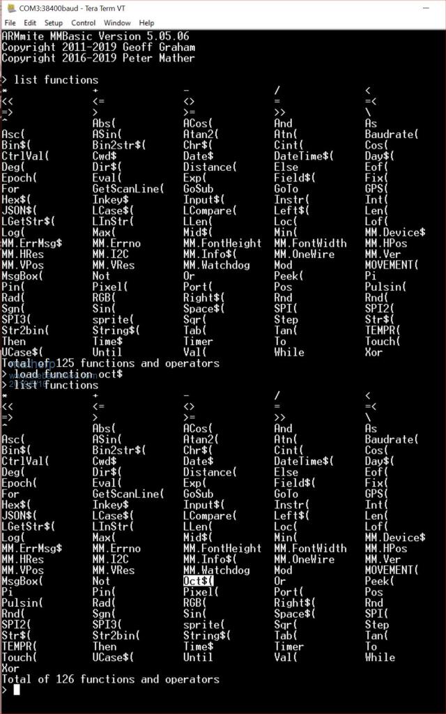

LIST COMMANDS will list all valid ArmmiteH7 commands
LIST FUNCTIONS will list all valid ArmmiteH7 functions and operators

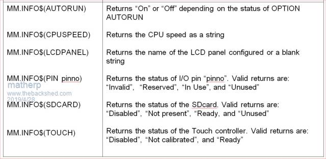

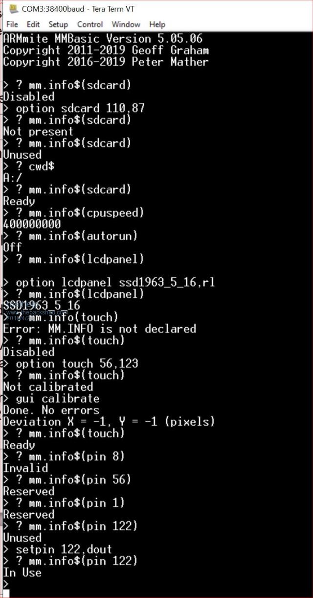

Minor addition of an information function. I'll add this to other ports as and when.
This also fixes a number of issues that occurred when a user defined function was called in the conditional test of a DO WHILE loop or in the parameters of a FOR-NEXT loop - thanks to Geoff for this fix.

  matherp said   Minor addition of an information function.
I hope this goes into all MicroMites.

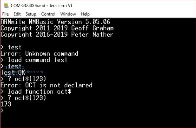

  Quote  Just curious - the current output of the "list commands" and "list functions" on the v5.05.06 H7 code shows 127 of each. I thought the current limit was 128 functions & commands - how do you add 2 extra functions?
I'm going to have to cull a couple of the lesser used functions - no decision on what yet.

Functions removed:
SPC(): already marked as obsolete by Geoff - use SPACE$()
MM.I2C2: use MM.I2C instead, this will be updated after any I2C or I2C2 command

Hi Peter.
I got the following error using the ssd1963_5_8bit type:
> option lcdpanel ssd1963_5_8bit,l
> backlight 50
Error: SSD1963 display only
> option list
OPTION LCDPANEL SSD1963_5_8BIT, LANDSCAPE
OPTION SDCARD 110, 87
Gerard

Posted: 03:15pm 09 May 2019
  Quote  I got the following error using the ssd1963_5_8bit type:
That's easily fixed

Try this:
2019-05-10_231917_Armmite1.3.zip
I've also solved the number of functions and commands issue
I'll make many of "my" commands and functions loadable and that way users can select which they need for a specific application.
The LOAD FUNCTION and LOAD COMMAND commands cannot be used in a program for obvious reasons, but they can be put in MM.STARTUP so that they are set up as part of boot sequence and are then immediately available for use.
There is no performance impact of this approach
