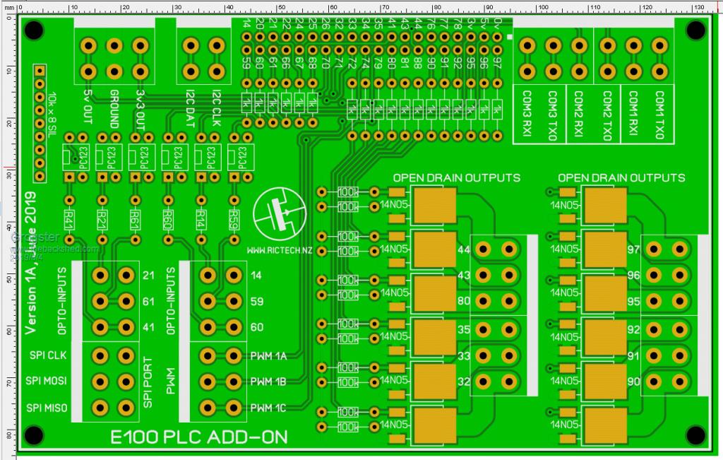

Howdy.
This board is an add-on to the E100, and turns it into a PLC - Programmable Logic Controller. Often you need to connect either more then 3v3 signals to the E100's CON8 connector, or you need to be able to switch a reasonable current with one of the outputs. As the board sits, you can't do that without extra circuits, so this board is designed to provide that, and to mimic the commercially available PLC's that can be had for considerably more cash.
The features of this add-on board are:
- Six opto-coupled isolated inputs
- SPI port
- I2C port
- Three COM ports(COM1, COM2 and COM3)
- Three PWM pins (PWM 1A,1B,1C)
- Twelve high-power open-drain MOSFET outputs
All connections are via spring-loaded terminal blocks, and all parts are through-hole for easy assembly with the exception of the MOSFET's.
This board will bolt directly onto the rear of a standard E100 unit.
The MOSFET pins are all standard I/O pins that are not currently assigned to any special function, so nothing will conflict.
Each MOSFET can easily handle 2A or so continuously. Higher currents can be passed up to 10A or so, provided you de-rate the device and use a suitable duty-cycle to allow the MOSFET's to cool off. You could also fit a couple of rectangular self-adhesive heatsinks to the two columns of MOSFET's to aid in cooling. NONE of the MOSFET output stages have ANY kind of back-EMF snubbing, so if you wanted to drive motors or solenoids, you would have to add back-EMF diodes yourself. This is very easy to do externally on the motor or solenoid itself. For purely resistive loads, no external diodes are required.
The numbers beside the terminal blocks are the E100 pin numbers they are connected to. The likes of the COM ports, I2C port, SPI port and PWM pins can all be used as standard unbuffered I/O pins if you are not using the assigned special functions of those pins, naturally.
The opto-coupled inputs can have any voltage from about 2v or so up to 50v or so applied to them, and they will isolate and couple this to the E100 pins. The six resistors on the opto-couplers need to be chosen based on the voltage you are planning to connect to these inputs, to provide the correct IR LED current.
I have ordered some of these boards, but if anyone is seriously interested in this, I can build a constructors pack and upload it to my website.

Hi Grogster,
I have been using PLC's for a while. There are some things typical about them that you could incorporate in your version of the PLC board.
Typically PLC outputs drive high (they pull the load connected to ground to +24V).
Typically PLC inputs sink current (like your optocouplers), but need at least 2mA before they see a "high" level. That is to support 2 wire sensors (like 2 wire hall sensors).
Inputs and outputs are protected.
Serial ports: PLC's typically support RS485 (modbus) protocol. If you design 3 serial ports, you may want to change 1 into RS485.
Maybe you are capable of squeezing in these features above through "optionally loadable" components. Would make your board more versatile.

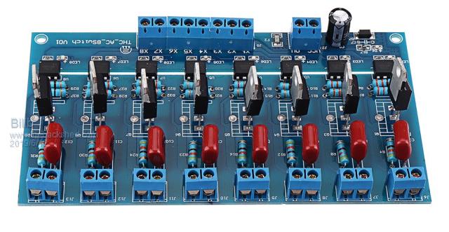

I have used this board from banggood were I required a PLC type interface
at AU$27 it is reasonably priced.
https://www.banggood.com/8CH-Channel-PLC-DC-Output-Transistor-Amplifier-Isolation-Plate-Board-p-1497172.html?rmmds=newAr rivals&cur_warehouse=CN

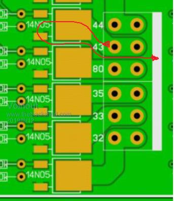

Another thing you may want to look at is the current flow through the power MOSFETS.
There are thick copper traces to the connector (from the drain).
But how the the ground current flow ?? I hope there are some via's near te source pins..??
Success,

Hi there.
Outputs 90-97 connect directly to the surrounding ground-plane, but yes, outputs 32-44 don't have ideal ground current paths. I will improve on this.

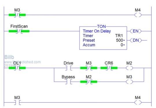

this is a sample of ladder logic that is the basis of most PLCs.
Bill Edited by Bill.b 2019-06-14

  Quote  this is a sample of ladder logic that is the basis of most PLCs.
That's a perfect example of generic PLC ladder!
(Just out of interest, I looked at my old Omron CS1 Programmers Reference book... There's 1400 pages of functions and programming descriptions in it. That's just for ONE series of PLC in the Omron range!)

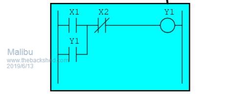

LOL... it's actually pretty simple, just a different schematic style than what you're probably used to. Try this one as something easier...
A straight forward motor stop/start.
Any element on the right are the controlled devices (even internal ones like timers, counters etc...) and in this case it would be a contactor output for a motor.
Any element to the left of this is controlling device (switches, proxes, internal contacts etc)
In this case, 'X' are inputs & 'Y' are outputs, so on the top line, when X1 (a N/O start button) is closed the circuit is made through X2 (A N/C stop button) and turns Y1 on and the motor starts.
On the 2nd line, Y1 is an internal 'software' contact (that works with the output) closes in parallel to X1 and when X1 is release, the Y1 output remains on (Y1 here is a hold in contact)
The motor runs until X2 is pushed, opening the circuit, turning off the output, dropping out the hold in contact ready for the next X1 push.
In the old programming style, this would be written as :
LOAD X1
OR Y1
AND NOT X2
OUT Y1
(If my memory doesn't fail me)

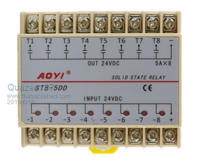

My Pi w Zero's is setup as PLCs and I use these for output
Din Rail Mounting.
My inputs are optocoupler based.
Have a look here OpenPLC

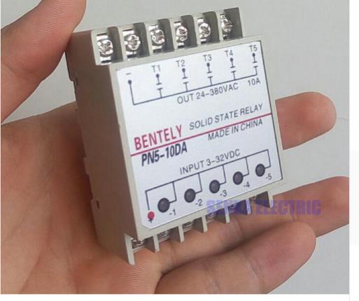

Agree re: Outputs driving high. I use SSRs pretty much exclusively (dirt cheap on Ali-whatever) unless I need the isolation of mechanical contacts. Mechanical relays don't last very long, in my world, when switching DC inductive loads (hydraulic solenoid valves). I would/am considering MOSFETS on the PWM outputs, though, because I can electrically regulate the valve flow and eliminate manual adjustments during machine setup. P-Channel would be more convenient though or I have some more rewiring on my hands.
