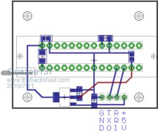

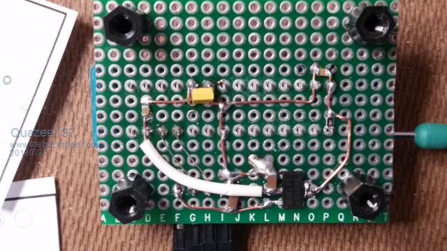

Wired this up last night on a piece of perf . surprised it went so easily

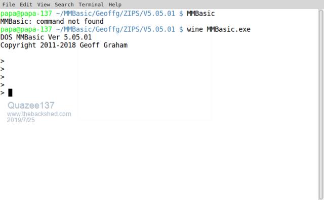

Havent been able to run under linux. Dosbox does indicate it needs Windows. Wine doesn t like it either. I would have spend more time on it if the dos version had some elementary form of graphix.

Volhout Thanks for trying too. I tried a few ways still no luck.
Funny thing I created a folder and put MMBasic.exe in it.
then opened folder in a terminal
then type wine MMBasic.exe
I get this
I can ^C and it responds moving the > down a line. But no other keys work.
So near but so far away. Other ways to do the program but this just
seems right. With SYSTEM command-line$ MMBasic could be like a bash/bat
doing the bit handling and passing the file out to Pic32Prog

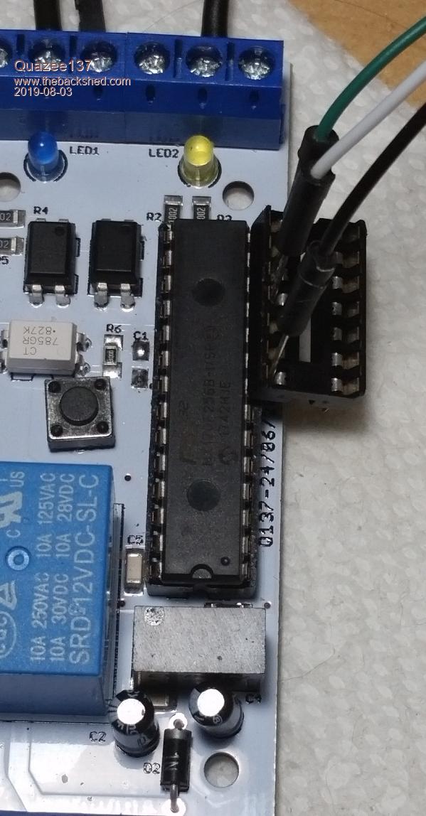

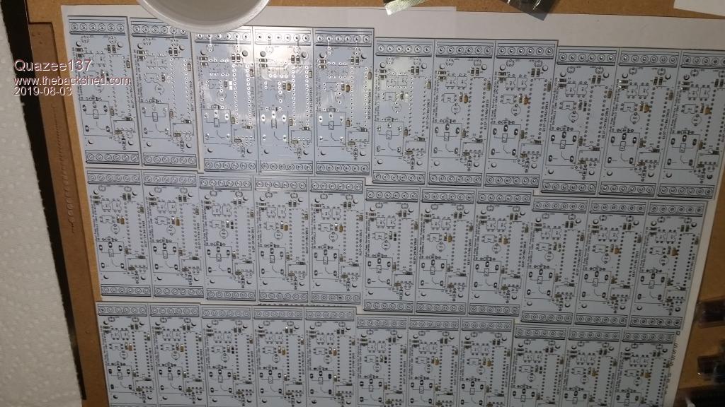

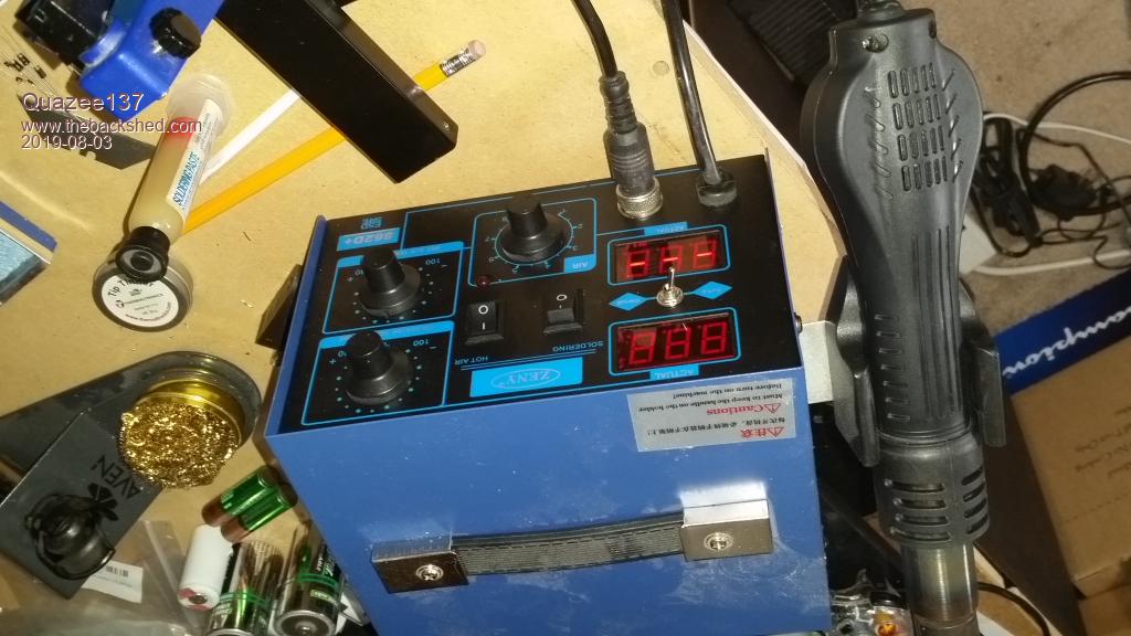

I did flash the 60 chips and loaded the program just waiting for boards
and din rail cases. Then the fun of hot air reflow. Been testing it out
not to bad with solder paste.
Thanks for the help and insight

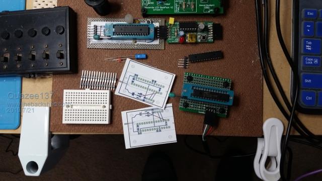

Rob I used the bridge to connect to a zif'd 170 board to read the three files.
It's also the way I put MMBasic on the 60 chips. Then used the zif one I
posted to upload the basic program.
It was when I made the usb to zif that got me thinking of using Pic32Prog
to read the preset up chip and do MMBasic + program + options for the rest.
