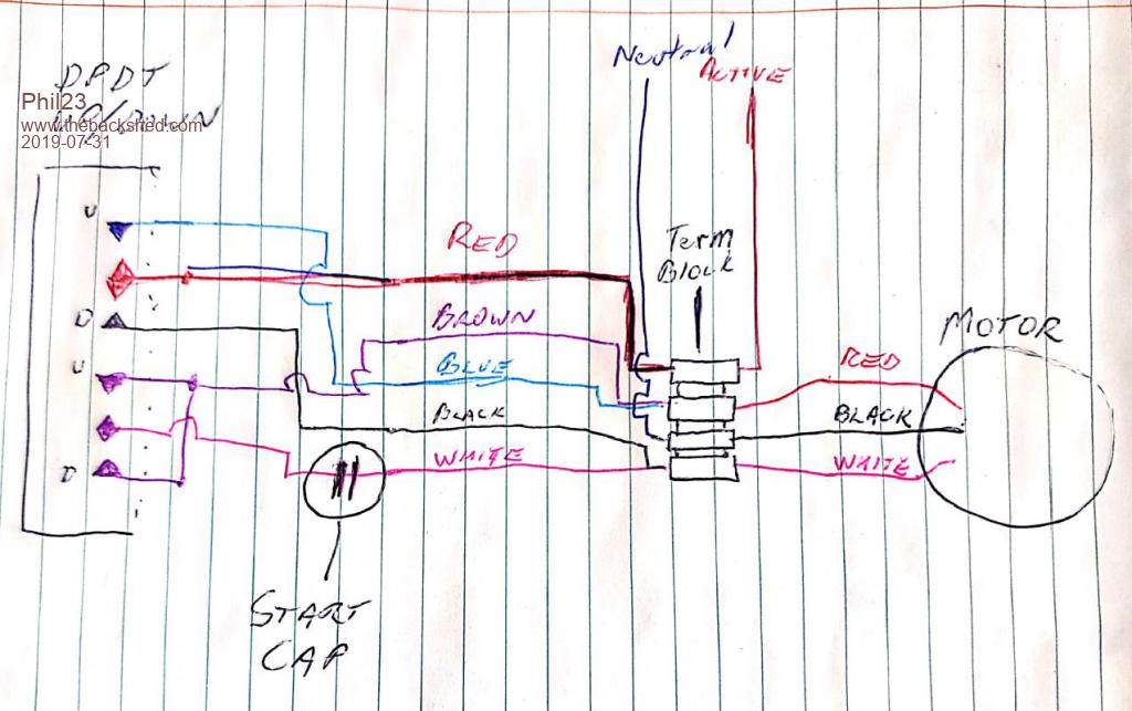

Hi All,
I was "Gifted" a lifting hoist that didn't work out of the box & was replaced by the supplier.
https://www.kincrome.com.au/lifting-hoist-400-800kgs
It's a 400kg bolt to the rafters thingo with a 1300W induction motor.
Was passed on to me as the supplier said dispose of it.
When I hit the up or down buttons it just makes a clunk & the motor hums.
The parts diagram shows a brake disc which I think is what clunk is.
Looks like it gets pulled towards the windings to disengage.
Drew this rough mud map of the wiring as I suspected that there may be a wire wrong somewhere & not sure about how you wire reversible induction motors.
Get the impression that it might be related to how the Starting Cap is wired.
Haven't studied it too hard yet, but any help would be appreciated.

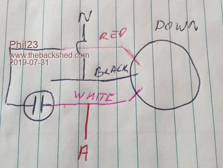

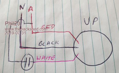

Basically,
Once I've traced it out a bit it just looks like this for Up & Down.
Wondering now how I identify the winding taps from the motor.

Scrap All of the above....
I investigated what I was avoiding & putting at part 2.
Mechanical issues...
Removed the fan cowl & motor was stuck even with the brake disengaged;
Pulled the end of the motor & back on with a bit of grease on the spline & now it works just fine....
Cheers.

That system is typical and clever.
It uses a centre tapped winding RED BLACK WHITE.
In the UP direction ACTIVE is applied to the RED PHASE and the WHITE PHASE gets a phase shift due to the CAPACITOR.
In the DOWN direction ACTIVE is applied to the WHITE PHASE and the RED PHASE gets a phase shift due to the CAPACITOR.
The first time you come across it you start to doubt your sanity.

To add to the above it seems as though in Phil's drawing the run and start windings must be similar so in the up direction white is start and in the down direction red is start.
