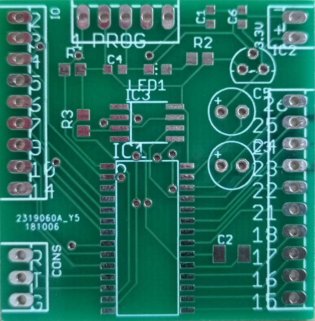

Hi All, I am playing around with a layout for an Extreme64 based PCB. (very early stages) As usual I am trying to keep this board as small as possible.. Due to the fact the VGA is not available on the X64 is there a need for the Mouse and keyboard PS2 connectors? These are relatively bulky and it would be nice to not have them on the board.. I am after opinions as whether these are really useful on the X64 or not.. I can utilise the space for other items Anyway I am interested in your opinions. Kind Regards, Mick Mick's uMite Stuff can be found >>> HERE (Kindly hosted by Dontronics) <<< |

Personally I like the PS2 keyboard option, but that is just me. Try to find space for a Winbond Flash memory . I know the MMX can't do CSubs but you can drive the flash rams from MMBasic quite easily. The speed of the X will make it realistic enough I think, no? Edited 2019-09-07 00:04 by CaptainBoing |

Hi Capn, Thanks for the reply,, Nice little chip and cheap (W25Q64FVSSIG) at about $1 each.. But I need to know for sure that one of these can be used on the X64 driven from basic otherwise it becomes a waste of space. We all know my ability (or lack there of) to program so I doubt I could write code to test it. Re. The PS2, I am exploring a couple of other options (Piggy back plug in PCB) or header pins and a converter cable (prob using one of those 2 PS2 to USB cables and modifying it) as I am trying to squeeze everything onto a 50mm square PCB.. So far it is looking ok but those damn PS2 connectors are taking a lot of room. Kind Regards, Mick Mick's uMite Stuff can be found >>> HERE (Kindly hosted by Dontronics) <<< |

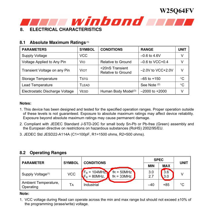

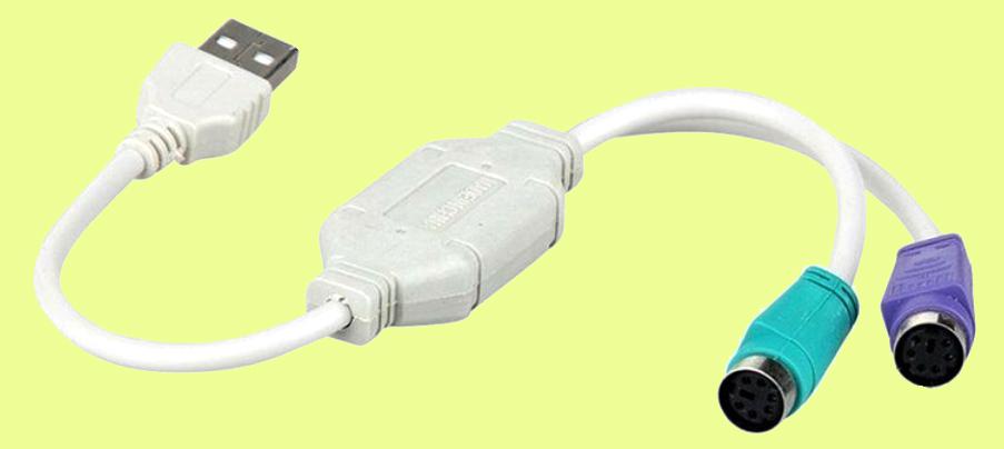

Hi All, Thank you for your input. I most likely will scrap the PS2 connectors as they take up so much room, and use a header to gain connectivity if required, I might make a small daughter PCB that has the Audio jack and kb/mouse on it.. I have ordered one of these to strip down. ![]() It would be easy enough to use the cables and terminate them at a header to match the main board.. As to the flash memory, I have bought 10 to play with (A massive 55c AU each for the W25Q64FVSSIG). I have had a quick scan of the data sheet and I am a little concerned about the following specs. ![]() I am yet to determine what Fr really means but if operating at 80MHz/33Mhz the max Vcc seems to be 3.0v Hmmm... I am sure they work well but just a thing to ponder Kind Regards, Mick Edited 2019-09-08 12:18 by bigmik Mick's uMite Stuff can be found >>> HERE (Kindly hosted by Dontronics) <<< |

| ceptimus Senior Member Joined: 05/07/2019 Location: United KingdomPosts: 130 |
I read that spec. as saying you can run at the higher frequency with the higher voltage supply. This is quite normal. So you can run at a maximum of 80/33 (I guess they are the figures for the two directions?) with a 3-volt supply, and the speed limit increases to 104/50 when you have a 3.3-volt supply. |
bigmik![]() Guru Joined: 20/06/2011 Location: AustraliaPosts: 2981 |
Hi Ceptimus, It possibly does mean that but I feel that it looks like it is in reverse.. It states the Fr as (CONDITIONS) so I read the Vcc being max 3.0v Very confusing.. but some people apparently have this working OK.. What sort of Fr would an X64 at 200/252 MHz create? On the same agenda should I look at the 2 bit or 4 bit SPI options? that would take either 1 or 3 EXTRA IO pins? I would provide a pad for access if required. Interesting... My MZ chip and 24Hz Xtal arrived today so I am just waiting for my TQFP-header pins adapter to breadboard a bit of the circuit. I was also a bit surprised at the price of the MZ chip ($22AU from RS Components and not much less from Mchip) Regards, Mick Mick's uMite Stuff can be found >>> HERE (Kindly hosted by Dontronics) <<< |

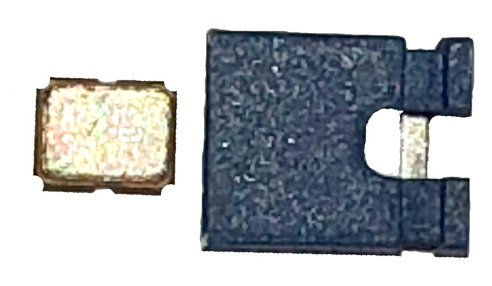

@Brian, Actually, (Yes I know you were joking), I almost couldn't find it in its plastic bag.. It is a whopping 3.2mm x 2.5mm and was darn hard to solder some wires on to test it in my X144 board. (yes it works fine even without the pin 1 mod). This might be a challenge for someone to solder but then the 0.5mm pitch on the MZ is not going to be for home handyman solderers either. Flux will be a must. Here is a rough as guts picture next to a 0.1" shorting link ![]() Kind Regards, Mick EDIT !!! Wow! Look at the size the image came out as.. Edited 2019-09-09 12:16 by bigmik Mick's uMite Stuff can be found >>> HERE (Kindly hosted by Dontronics) <<< |

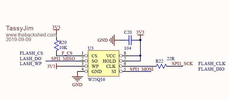

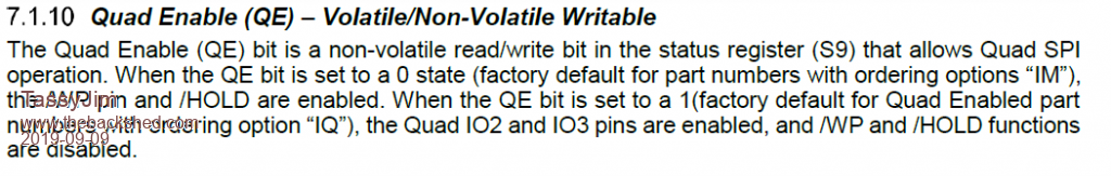

TassyJim![]() Guru Joined: 07/08/2011 Location: AustraliaPosts: 6606 |
I have been playing with the W25Q16JV which comes on the STM32F4 board. The data sheet is similar to the W25Q64FV. This is the circuit for the flash chip: ![]() Note the 3.3Vsupply and also the WP and HOLD pins tied to 3.3V The chips supplied on my boards are of the variety that default to QUAD ENABLE being set! ![]() The speed I am using to talk to the chips is: SPI OPEN 1000000,0,8 I haven't done anything more than read the serial number and status registers etc but will try saving and retrieving data next. As it is not a MX chip, I can't use Peters CFunctions but the exercise has been good for the grey matter. > RUN Device ID = EF14 JEDEC ID = EF4015 Serial No = E66840D843431B36 Status registers: 1 00000000 2 00000010 3 01100000 1 00000010 2 00000010 3 01100000 > I think you will be safe with 3.3V Jim VK7JH MMedit |
