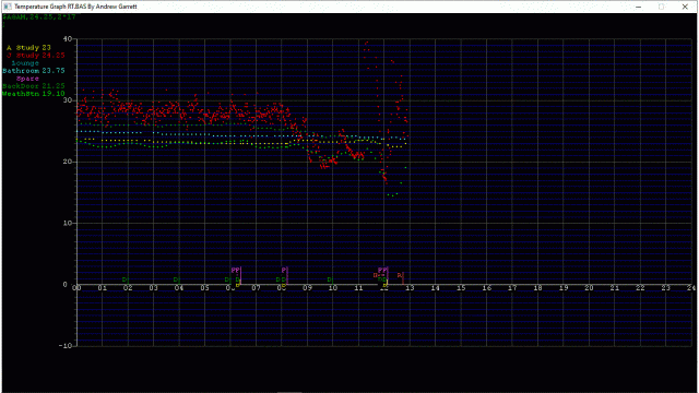

Hi All,
I want to log when my gas hot water service (HWS) runs (approximate time of day and duration) - to help plan my new solar/heat pump installation.
It is about 10 years old with a pilot light and thermocouple.
Do any of you have ideas or comments??
(I don't want to break into the gas supply side but could after the control valve - but gas flow sensors are not cheap.
I have a number of DS18B20 encased in a bullet-like tip and a lead long enough to get indoors to my study. One simple solution is to locate one near (but not too near) the burner so that hot is "on", cool is "off". There will be a little lag and I'll need to locate it carefully but it should work. The MM side of it is simple. I'm just checking to see if you have better ideas.)
Andrew

What about a VERY simple thermistor (only cost a few cents) attached to the flue? You would very quickly see when the gas was on...
You could make the thermistor sensing a low impedance loop to the MM - then no need for fancy signal processing or whatever. No need for any accurate measurements, just to know when the flue temp spikes. Run the thermistor loop from the MM 3.3v supply, no need for any level translations.

Maybe a „Flammen - Sensor“, like this: LINK
Wolfgang

I like the idea of putting any "sensor" in the flue as this helps manage the temperature.
I'll experiment and report back.

If you stick a sensor in the flue it will eventually get gunked up with all the muck going past,
If the flame is visible an IR sensor may work.

If your attach a thermistor or whatever sensor to the outside of the inner insulated flue pipe you should get fairly accurate readings with no worry about it becoming polluted...

The plasma in a burning flame is electrically conductive. All you need is a metal electrode poking into the flame, a very high resistance pullup resistor and a cmos logic gate.
Logic high, no flame, logic low flame present. You will need a good quality stainless steel electrode that won't burn away, and a ceramic insulator to support it.
The spark igniter electrodes used in gas stoves are available on e-bay, and would be ideal. This is just one example:
https://www.ebay.com.au/itm/Gas-Grill-Ceramic-Igniter-Electrode-Pin-Spark-Ignition-Cable-400mm-For-Heater/163650519219?ssPageName=STRK%3AMEBIDX%3AIT&_trksid=p2060353.m2749.l2649
But to just experiment with initially, a nail or piece of steel wire will work just as well, for a short time anyway.
This electronic flame sensor method is used in most types of modern automatic gas appliances these days, and is usually connected to a microcontroller that controls the spark ignition, and gas valve.

Hi all,
Some interesting comments - please keep them coming.
Here is an update.
Because I had some, and it was easy, I put a DS18B20 probe just into the HWS flue (exposed to both exhaust gases and ambient air flow).
A simple MM170 circuit uses an HC-12 to show the temperature every minute on my PC (and every 15 seconds on an LCD BackPack).
In this image the HWS plot is in red, the two green tracks are external air temperature (every 10 minutes).
Some observations:
- there is a lot of scatter in the 1 minute readings - WHY? My other (green) temperature sensors are more sheltered and may be less effected by wind. There is no averaging employed.
- my HWS is sick, it sometimes doesn't fire up despite a long shower (at about 10:00) (confirmed by the pilot being out). That little rise just after 10:00 is more to do with ambient temperature - not the HWS. When I lit it (about 11:10) the displayed temperature shot up to above 40degC (off the plot) and came back down before 12:00.
- just after 12:00 there was a second shower and the HWS fired up (as it should) to just over 40 (off scale). This means it sometimes works. Its temperature tailed off after about 12:15.
- I am surprised how quickly it heats the water after a shower!
I can thus detect when it is on (ie when it is above say 35 and ambient isn't) vs off (ie when it is closer to ambient).
I have another possible option. Before embarking on this "project" I replaced the thermocouple (which I now suspect was OK). My DMM shows a change in resistance when I heat it (but I cannot trust the reading as it sometimes shows a negative value) - can I place that nearer the gas ring and get a more direct measure. How would the circuit look?
(Beginner's question I know, but, how does the HWS use a change in resistance on the thermocouple to sense heat when there is no power source to the HWS?)
Cheers,
Andrew

Unless you specifically want temperature, you only need significant change from ambient. I would go for a really easy option here of two thermistor/resistor voltage dividers and simply monitor the junctions.
