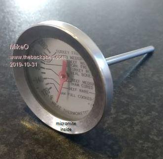

Posted: 09:03pm 30 Oct 2019
Here's mine,
Codenquilts

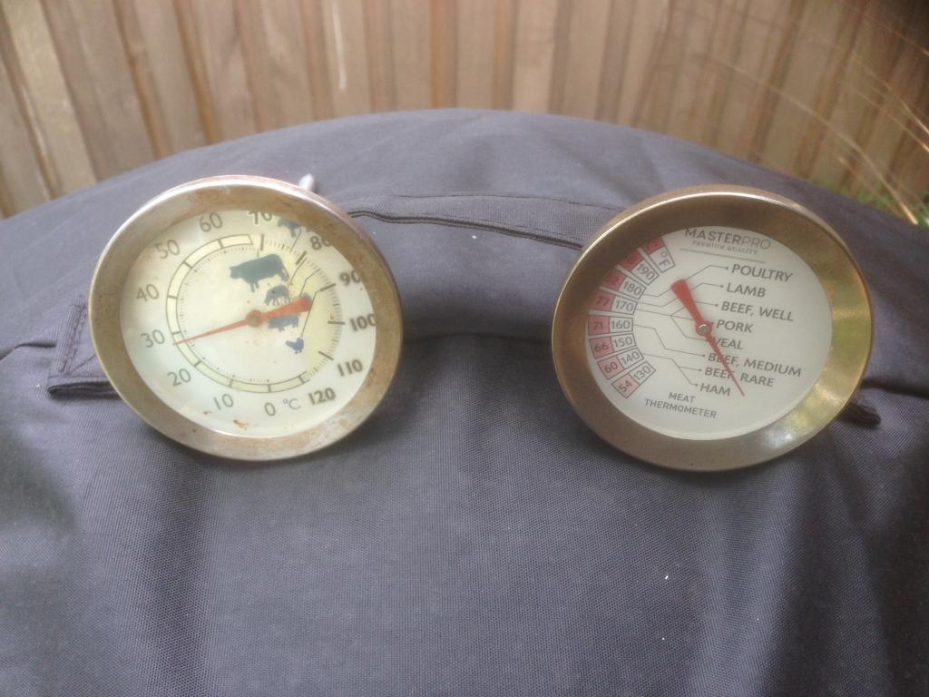

Posted: 12:13am 31 Oct 2019
Thanks Mike ,
Here are two of mine (Oven & BBQ).
Cheers,
Andrew

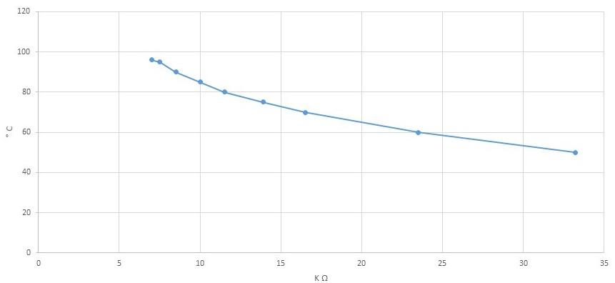

I bought the Weber probe today - as much to play with it as anything else - only Au$20.
For the first meter+ the cable is intended to be BBQ-proof (at least 300 deg C) (but they do have short lives). They have a $150 device, called an iGrill that it plugs into to measure its resistance etc. on a nice screen with buttons.
I've measured the resistance resulting from temperatures ranging from 0 to 96 degC (ie 240K Ohm to 7K Ohm).
The important range is really only 50 to 96 degC, ie 33K to 7K Ohm.
Now I know the resistance range, the big question is how to measure it with a MM170? ie How to measure a voltage across say 33k?
Cheers,
Andrew
Here is a plot of the Temperature vs Resistance readings from 50 to 96 deg.
Edited 2019-11-07 19:42 by Andrew_G
Posts: 6116
Posted: 08:08pm 07 Nov 2019
That is simple.....
The adc on a mx170 is using the 3.3v as reference voltage.
If you connect 3.3v to the probe, and the other pin to the adc.
Then connect a 10k resitor from the adc pin to ground you created a temperature dependent voltage divider.
When the probe is 7k the voltage at the adc pin is 3.3v x 10k / (7k +10k) = 1.94 volt
When the probe is 33k the voltage at the adc pin is 3.3v x 10k / ( 33k + 10k) = 0.77 volt
A conversion to temperature can be done with linear interpolation, but better with curve matching using the measurement points you already measured.
Success.
P.s. You may get slighlt better resolution if you use a resistor of 15k, in stead of 10k. Replace 10 with 15 in abover formulas. The difference between minimum and maximum adc voltage may be bigger, giving better resolution.
Edited 2019-11-08 06:12 by Volhout
Andrew_G
Joined: 18/10/2016
Posts: 901
Posted: 02:23am 08 Nov 2019
Many thanks to Volhout and BigMik (who has been helping off-line),
Because I will be calibrating the setup it is not critical that each reading is precise. As long as I know a reading of X volts represents Y degrees I'm in with a chance.
I have settled on a 22K resistor to earth. That gives me about 0.25V at 0deg,
and <3V at 100deg - that range will do me.
I had been worried about the internal impedance in the MM (as described at the bottom of page 52 of the manual).
I've tested this out on breadboard with fixed resistors - the MM voltage readings are remarkably close to spreadsheet values - but I will still calibrate it.
I'll report back in due course,
Cheers,
Andrew
