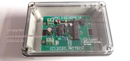

Hi all.
I needed a wireless link that would fit into a standard single wall-plate, so I came up with this:
What I needed, was a simple door-switch that would send a certain code to a base-unit, so I came up with this design, but expanded it so that not only the switch input(SW) is available, but also all of the unused I/O pins for maximum flexibility.
The PCB is designed to fit into a PDL 600-series single wall-plate(a blank one such as 650VH), as in the system I wanted to use it with, all the other call-points etc were on single wall-plates, and powered by a common 12v DC-bus via 4-core security cable.
If anyone is interested in this, I can build a constructors pack and make it available for download from my website along with demo code, BOM etc.
The PCB is still in alpha, so it might have errors, but I will discover these when I build the first few - which have been ordered.

Good timing. I put in an order for some HC-12's from you yesterday & just sat down to plan out a bit of a MM radio network to get rid of some hard wiring I have around the place.
Your board probably would suit one of my needs.
Could you confirm that the board itself is about 65-66mm wide?
Brian

@ Chopperp: Yes, 66mm x 89mm.  Designed to be a perfect fit in the rear of a PDL 600-series blank wall plate.  It will fit either the 650VH or the 650BVH.
Assuming you can get the PDL wall-plate series in Australia?  I would expect so - yes?
I think that PDL are now called Schneider Electrical, but the codes are still the same so I understand.

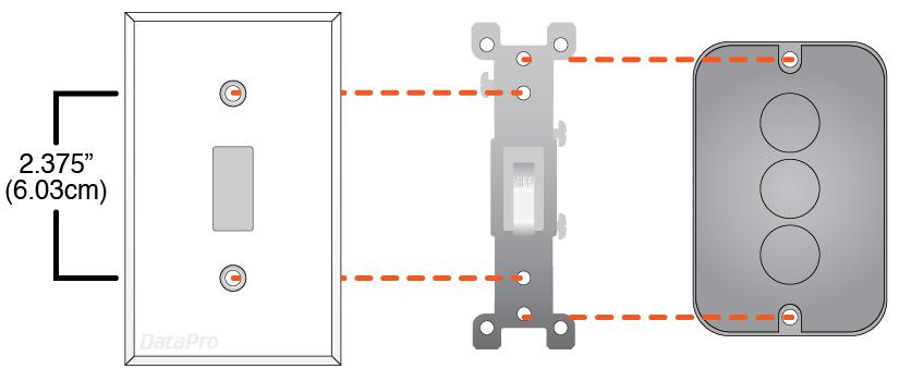

Clipsal and HPM both have them here in OZ, just a standard wall plate and mounting block if you want.

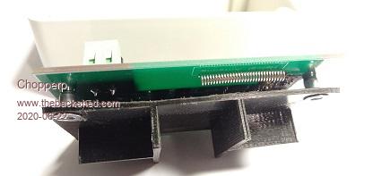

Posts: 10041
Posted: 06:45am 19 Feb 2020
My PCB's have arrived, so I have built one into a PDL 650VH blank wall-plate:
Demo code:
