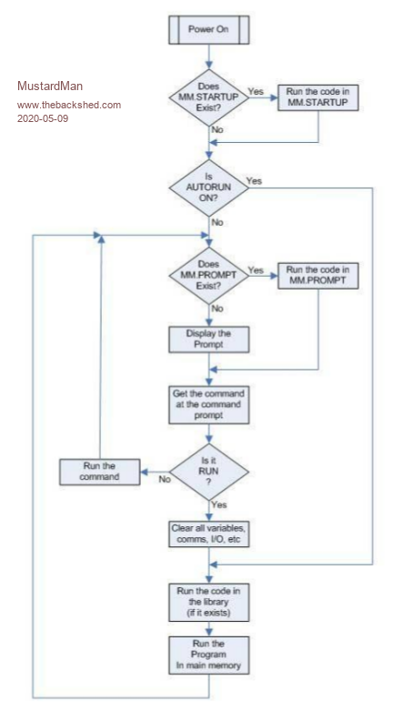

Perhaps it is the autorun getting there first... I know I saw a flowchart of what happens at turn-on / reset, but for the life of me I can't find it. The documentation is quite good, but it is horribly scattered and you need to peruse several manuals and collate all the tidbits from each.

Posted: 12:56am 09 May 2020
The flowchart is on page 47 of the latest Micromite User Manual.

Finally found that flowchart...
Looks like the AUTORUN test is pretty early on.
