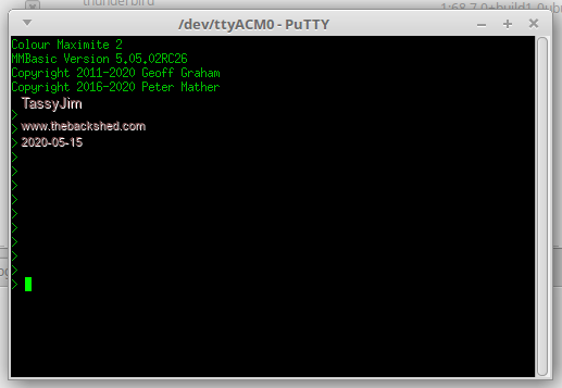

However I don't have a Win10 box in my "cave" and have been connecting to my original CMM using PuTTY running on a Raspberry Pi 3 ... I can't get that to work with the CMM2.

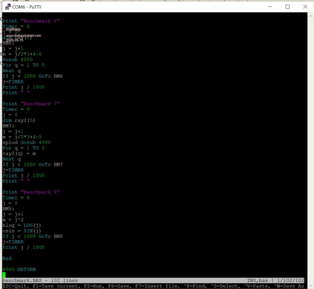

Putty works fine under W10
Check baudrate - must be 115200

Posts: 6606
Posted: 10:53pm 14 May 2020
I don't have a PRi with monitor attached but I can use Putty on Linux OK
The CMM2 should appear as ttyACM0 not ttyUSB0 etc.
During enumeration, Linux might complain about "failed to set dtr/rts" but you can safely ignore that message.
I DO run a CMM2 off a RPi using ser2net (but not with the microchip serial port), so I do know that they work well.

Have you set putty to VT100+ mode?
RC27 is sending ESC[20h which switches on VT100 LNM mode. I've checked it on putty on W10 and it definitely makes the difference if VT100+ mode is set.
