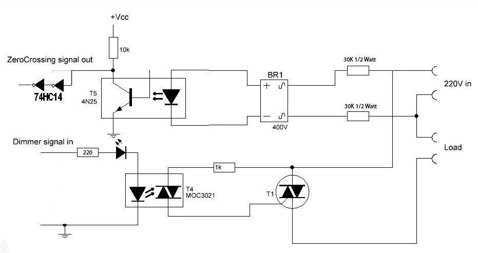

@Andrew --> The optically coupled zero crossing detector circuit you reference is the first part of the problem ... pinning down the exact time of the zero crossing. In the states we have a center tapped secondary in the utility pole transformer where the center tap is grounded. It might be more accurate to use a high value resistive divider to reduce the 240 v to 3 v and then use a comparator to find the zero crossing point.
Assuming I want a repeatability of +/- 0.1 ms in the turn on pulse and that it will take up to 110 clock cyles to process an MMBasic timer comparison then the uP clock period would have to be below .1mS/110 = 0.9 uS or a minimum frequency of 1.1 MHz which seems to be really sloooow.
Am I doing something wrong with the math?

yes I see your point. I don't like the voltage divider thing, dips in the power would affect it, it would be huge input impedance to your sense circuit and you have no protection from surges.
In practice that pulse you see on the scope is governed by the VF (or at least the behavior) of the LEDs in the optocoupler. As soon as the LED starts to burn, the transistor will begin to conduct. Any jitter (of which I never saw any) is entirely down to the frequency of the mains.
In practice, if you put a comparator or precision schmitt (probably using an op-amp) so you pick up the low voltages at the start of that quite slow leading edge of that pulse, you would maximise the time available to do your work and I think you'll easily get your precision - even at 1MHz, 0.1mS is a fairly useful chunk of processor time. In my instance it was a 4MHz PIC and it was so predictable I polled for it - not even an interrupt.
Suck it and see, what's to lose? An amusing afternoon with the breadboard

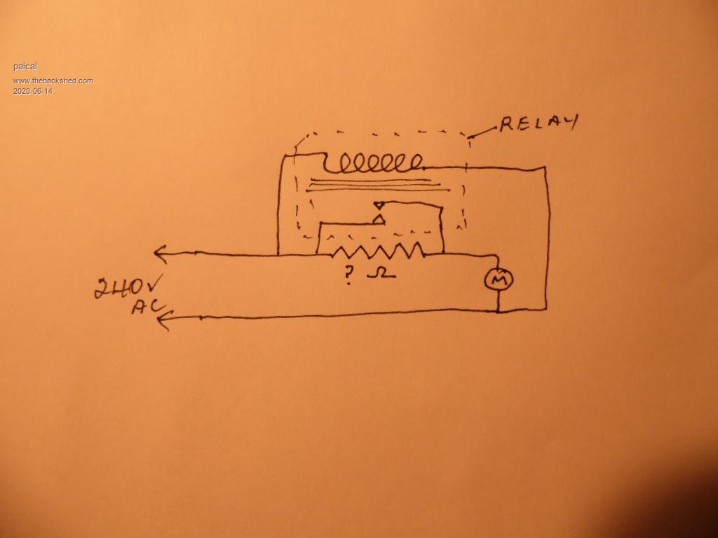

palcal
Joined: 12/10/2011
Posts: 2052
Posted: 09:17pm 13 Jun 2020
@ Lizby
      A very rough diagram
Sorry about the size.  The resistor has to be chosen to suit the supply, so if you have 5 amps available you could use say 50 ohms. The wattage has to be large but not the calculated wattage as it is only in circuit for a fraction of a second. As I said I used it on a small scale to run a fridge that only drew .8 amps but still overloaded my generator on start. The resistor only has to be in circuit until the back EMF is generated by the collapsing magnetic field in the motor winding.
In Paul L's case he would need a fair lump of a resistor, and it probably would not be possible. Delaying the relay for maybe a second would also help.

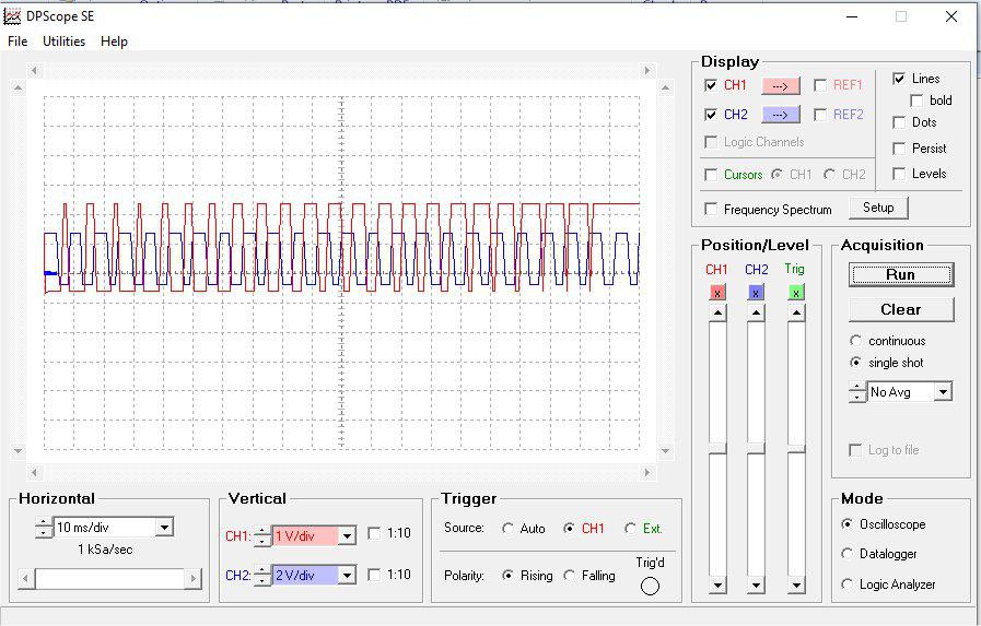

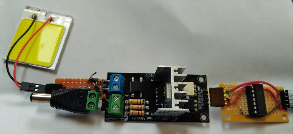

Here's proof of concept for an AC "cycle slicing" process using a PICAXE 08M2 and an ebay/amazon/aliexpress zero-crossing + triac control module:
AC dimmer module
Mains frequency here in North America is 60Hz, so there are 120 zero crossings (for half cycles) per second. This means that each half cycle is 8.33ms, so time-slicing after the zero-crossing detection has to be within that time frame.
I happened to have an old 12V AC wall plug transformer, which made testing safe and easy. It turned out the module detected zero-crossing with no problem using that transformer.
I found what appears to be the circuit diagram for the module here: https://www.instructables.com/id/Arduino-controlled-light-dimmer-The-circuit
(I added the two gates on a 74HC14 schmidt trigger inverter to sharpen the zero-crossing signal.)
For the PICAXE, I set the frequency at 16mHz instead of the typical 4mHz. This means that the PAUSE 1 command which normally pauses for 1ms actually pauses for 312us. Increasing to PAUSE 2 adds 250uS; the same for additional pause times. So I started with a pause just short of the 8.33ms after zero-crossing, and then fired the triac. I reduced the pause time after a certain number of half-cycles--32 half-cycles with the same pause and 26 250us steps gave me about 4 seconds to ramp up to nearly full on (at which point with a big motor, you would switch on a relay or SSR to provide full current).
Here is what it looks like on my PC scope, DPScopeSE, the on-time ramped at each zero-crossing; the zero-crossing trigger is blue, and the on-time is red.
Here's the code with the approximately 4-second ramp.

I added a full wave bridge to the output of the module, and put on a 12V LED as load. The brightness ramps up over 4 seconds (though it's not dramatic). With a DVM attached the reading rises from 0V to 16V.
Here's a youtube video
