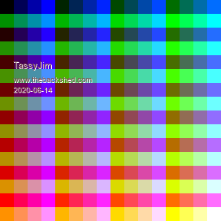

While experimenting with MAP and colour tables I found an interesting 'feature'
Try this program in 8, 12 and 16 bit modes.
 MODE 1,8

Modes 1,8 and 1,16 work as expected, drawing the colour chart then overwriting it with the saved copy.
mode 1,12 is the interesting one. Nothing appears on the screen but the colour chart does get saved as an image.
You can also uncomment line 13 and when the chart is drawn using RGB() it is visible as expected.
I assume its the dreaded transparency coming in to play, but unnerving when you can save an image that is invisible.

Posts: 6606
Posted: 07:27am 14 Jun 2020
Yes,
it is transparency.
change line 8 to
BOX x,y,20,20,1, MAP(n)+&hF000000, MAP(n)+&hF000000
and all modes work the same.
