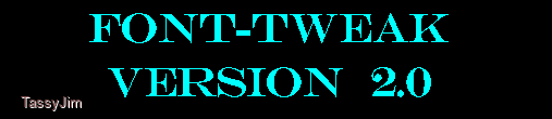

I have been playing with FontTweak
You can now import TTF files as well as use any installed font.
The sample above uses EngraverMT, a font that came with Windows.
It is 48 pixels high and makes use of my kerning subroutine.
TTF fonts work well for large text 32 pixels high or greater but small fonts will need a lot of tweaking.

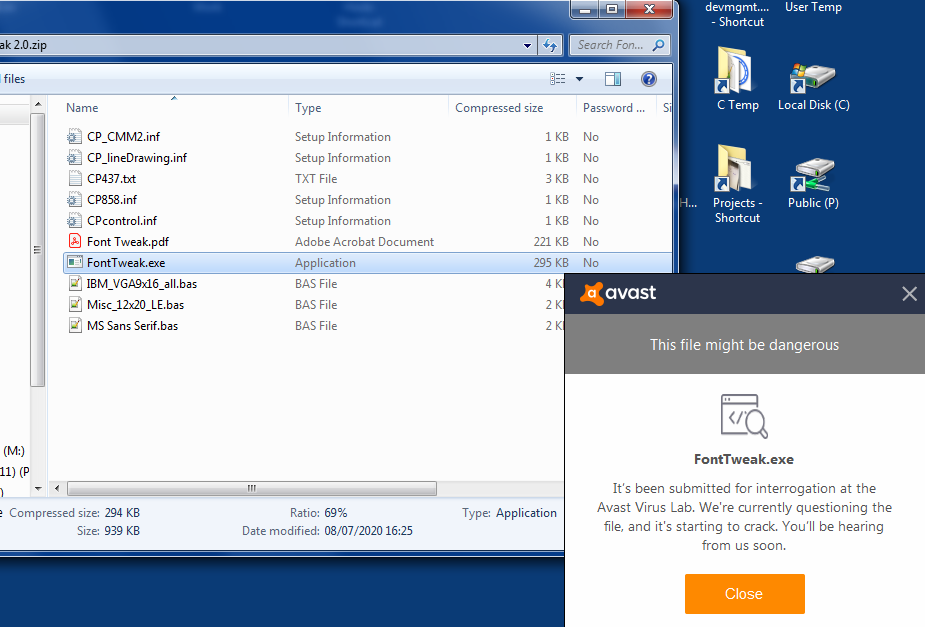

boo! another AV that gets the tom-tits about FontTweak. This happens a lot for this prog I hear. Weird coz it's a fairly straightforward application - perhaps a library call or something gets their diddy-donuts twitching. When (If) they come back, I shall harangue them for you and find out precisely what qualified it as dodgy then feedback (as an aside, I do not think for one moment it is dodgy).

Sorry about the virus warning but there's not much I can do about it.

no apology necessary Jim, I know it's not you.
I tried running it directly from the Zip (i.e. using the previous install's libs etc) and copied to another place on my PC but same.
I was chatting to a colleague about why this particular program and he pointed out that avast may not be very forth-coming on *why* for two reasons:
1. it is a lot easier (read cheaper) to simply "rubber-stamp" the prog as OK
2. they might not want to reveal a potential work-around for nefarious little scroats that have an interest in getting genuinely crappy software under the radar.
Another AV prog for the list
watch this space
