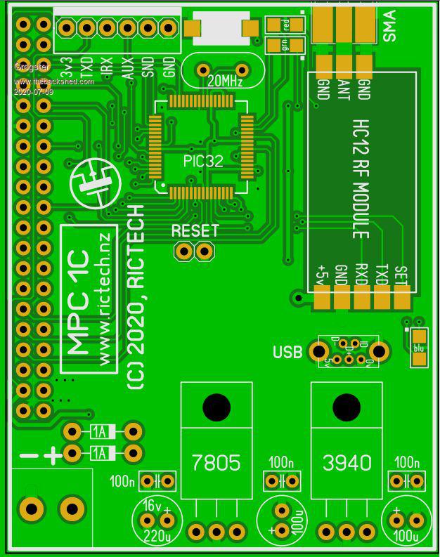

EDIT: Here is an image of my controller board:
Note that I have 1000uF 6v3 caps on the 3v3 and 5v supplies, which should surely be able to deal with any start-up current when the board tries to initialise the LCD....

Ripple could indeed be an issue as I am using external SM buck-converters for the 3v3 and 5v rails.  What confuses me, is that the 1st board works, which suggest that the PSU cannot be a problem, or it would not work either.
Anyhoo, I have redesigned the board, making it 15mm longer, and incorporating good 'ole linear regulator stages:
The large 'Green' area around these regs, is copper GP/pour, to act as a form of heatsink.  I plan to feed this from a single 9v supply capable of a few amps at least.
This will mean that the 7805 will dissipate about 1.19W of heat, which should be fine using the copper as the heatsink.
9v - 0.6v(diodes) - 5v = 3.4v, * 0.35A total load = 1.19W of heat.
If I used 12v input, dissipation of 7805 would increase to 2.24W, or 2.87W @ 13.8v input from a battery-backed PSU unit, which is PROBABLY what I will use.  This is still well within the dissipation of the 7805, albeit getting a bit on the hot side.
5W is about as far as I would be prepared to push it.  I can also add stick-on heatsinks for extra dissipation, but I guess I will need to run a few tests with this arrangement and see how hot she gets!

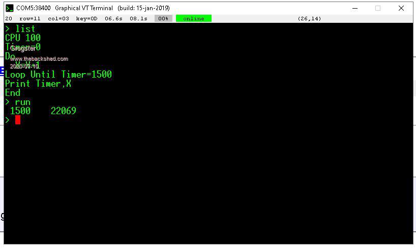

My first thought is power supplies, but another though I had was to set up a simple timing loop speed test both boards and make sure that both boards are running at the same speed.
There could be some issue that is related to the crystal..

Posts: 10041
Posted: 03:06am 10 Jul 2020
#1 test:
#2 test:
There is only 3 counts between them (22072 vs 22069), so they seem to be smack-on timing wise.  I guess I would need to do multiple tests and compare the results for true accuracy.

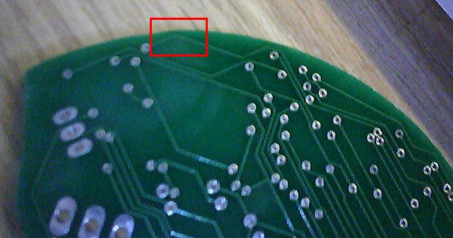

UPDATE:  Found out what was going on here, but first a little pretext.
I built the new version of the board, and low and behold - it did not work either!!!!
By this point, I was thoroughly convinced I MUST have done something wrong in the layout, simply cos I could take the LCD's that would NOT work on the new PCB, and plonk them on an E100, and they spring immediately to life.  That proves that the LCD module itself is not the issue, and it has to be something on my PCB layout that I have done wrong.
All data and control lines are 100% intact, and exactly where they should be, so the head-scratching begins - 'Why the hell won't it work then?!?!!!' I say to myself at 2AM......
Finally tracked it down to the LCD CS pin NOT being grounded.  It WAS connected to the surrounding ground-plane, and it did show as connected to ground when I tested the connection in the layout software, but it was on the outer edge of the PCB, and when they slice them up in the factory, that cut off the connection to the ground-plane.
"I think the phrase rhymes with clucking bell." - Blackadder.
So, what all this means, is that the original one that had the external buck-converter power supply for 3v3 and 5v was just fine - I resurrected it, and put a link wire on the LCD CS to a 'Real' ground, and it springs to life every single time.
Funny that.....
I guess what threw me, was that SOMETIMES it would initialise on one of the LCD's, but not the other one, yet BOTH of them worked fine on an E100 board.  Just luck that sometimes that one LCD would respond I guess, and probably interesting that it did at all, with CS floating.(cos technically, it should not)
