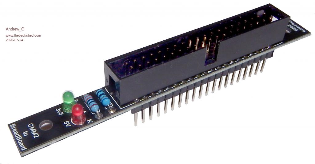

Andrew_G
Joined: 18/10/2016
Posts: 901
Posted: 12:44am 24 Jul 2020
Hi all,
I have one of the OP's items (I bought it in Aus. from Jaycar). Another problem with them is that, because of their width, they consume a lot of your breadboard. (because of that I haven't used it in anger - preferring to use Mick's).
I now have several of BigMik's Breadboard designs. They only take up one column each side of the centre leaving you plenty to play with.
Mick has also sorted the pin 1 to pin 1 issue (so I just use the 40-way female to female cable that came with the OP's device).
As Tassy Jim says you can get the 40-way cables most places or I now make them up with IDC connectors and cable.
Here is a pic off BigMiks website and you can see that the pins are a minimum distance apart for the breadboard (you can only see one row of pins - the other is only 8mm - 5/16" away).

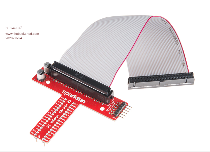

hitsware2
Joined: 03/08/2019
Posts: 738
Posted: 01:12am 24 Jul 2020
Good Point !
This one doesn't look too bad ,
and Colorado is way closer than
Down Under
my site
Posts: 6606
Posted: 03:23am 24 Jul 2020
  hitsware2 said  Good Point !
Down Under
I only count 17 pins either side.
Also the GND, 3.3V and 5V positions look suss to me.
I would prefer to use one that has the pins in the same position as the CMM2 connector.
On the plus side, the pins look closer together than the usual suspects.
hitsware2
Joined: 03/08/2019
Posts: 738
Posted: 04:00am 24 Jul 2020
I noticed after I posted ....Here's the one I ordered ...
my site
Posts: 2981
Posted: 01:59am 25 Jul 2020
Hi ALL,
@hitsware2
  hitsware2 said  I noticed after I posted ....Here's the one I ordered ...
Yes but that is the wide version that loses a lot of breadboard area..
Why would they do the 34 pin with a small width but go and make the 40pin one with a wider (0.6”?) width?
Seems dumb to me..
I admit I would prefer the cable horizontally but it isn’t that difficult to fold the cable so it is not really in the way.
If you want any of my PCBs I am happy to send you some, Postage (pre Corona) was typically 7 days from Aus but that has drifted to more like 14 days..  But the postage is a fickle thing..
PM. Me if interested in my version..  At least you dont have to worry about the orientation of the notch on the header as mine were designed with the CMM2 in mind..
