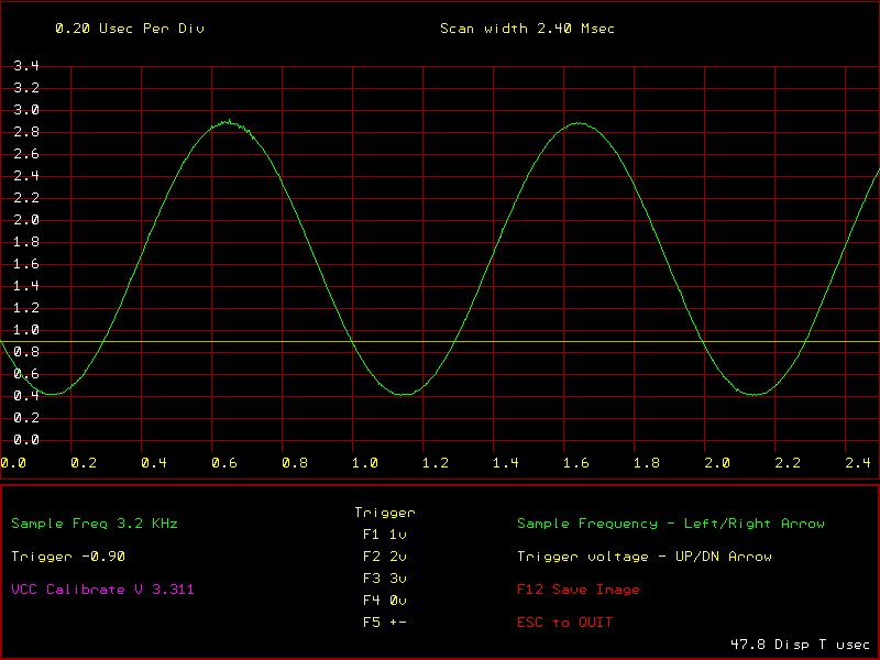

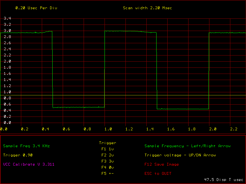

I’ve been wanting to have a play with the ADC on the CMM2 and was prompted by TassyJim and his really nice temperature sensor capture program. I wanted to be able to quickly change the Sample Frequency and Trigger levels on the fly and quickly came up with this little Oscilloscope program. 1: Sample frequency in 100Hz steps from 100Hz to 5KHz 2: Trigger level from -3.3 to + 3.3 and single key to switch Trigger polarity 3: Trigger line on display and time period follows sample Frequency. To show Sine waves the ADC input needs a DC offset at half the value of the P-P value of the waveform. Digital signals that aren’t negative going don’t need this. A quick and dirty way to show external sine wave (AC) signals is to use a variable resistor of around 100k connected between 3v and ground, the centre slider is taken to the ADC input and the sine wave signal is coupled with a 1uf cap to the centre slider. Turning the variable resistor moves the trace up and down the screen, at 1.5 volts a sine wave with a peak to peak voltage of up to 3 volts will show without clipping. Be sure to keep any input voltage to the CMM2 ADC below 3.3v Ideally you would an OP-AMP with adjustable DC offset for audio (analogue) work or digital signals that also go negative. Incorporated in a simple circuit would be adjustable gain with selectable input voltage ranges. Such as it is, the program might be a bit of fun for someone to play with. AudCRO.zip . NANO:Inverter V 8.4ks -Â Linux AvrDude GUI script V4.1 |

Hi, the average time is 49usec, the display at the bottom RH side of the screen is the total Sample + Display time in usec. NANO:Inverter V 8.4ks -Â Linux AvrDude GUI script V4.1 |

FYI, I added Peters FFT for a frequency readout, because I'm trying to cover 100Hz to 500Khz sample frequency it's slightly off on some samples rates but still in the ballpark and often spot on, it also depends on nature of the input signal. Mike. EDIT: Added Trigger on/off . Edited 2020-07-25 16:54 by KeepIS NANO:Inverter V 8.4ks -Â Linux AvrDude GUI script V4.1 |

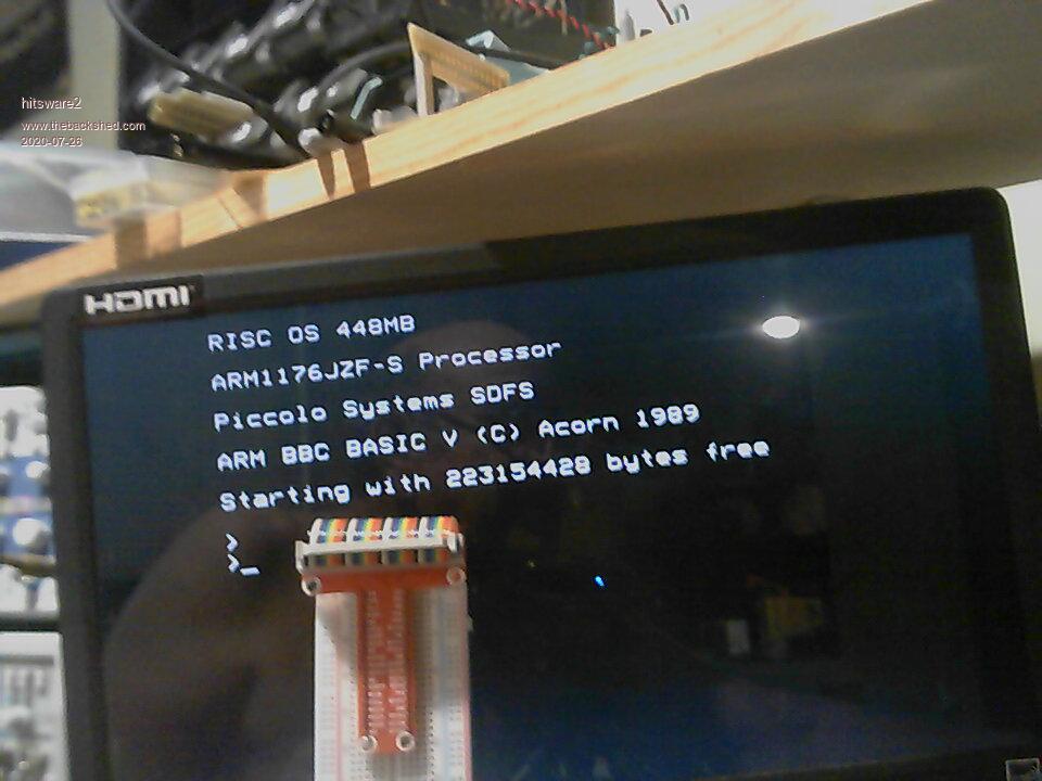

The pi doesnt have analog inputs. Bbc basic is fast, but not exremely fast. You can sample a pin in basic at roughli 1msps. For faster, up to 20 msps use the build in assembler. Ah..i think this post is in the wrong section. Edited 2020-07-27 02:57 by Volhout PicomiteVGA PETSCII ROBOTS |
| hitsware2 Guru Joined: 03/08/2019 Location: United StatesPosts: 738 |
The pi doesnt have analog inputs. I know . I am ( at this point ) simply trying to get a trace . I hadn ' t considered syncronizing with the display . I get what appears as row of flickering random dots : ( RISC BBCBasic has a WAIT that supposedly addresses the video problem but slows it to unusability . Edited 2020-07-28 00:54 by hitsware2 my site |

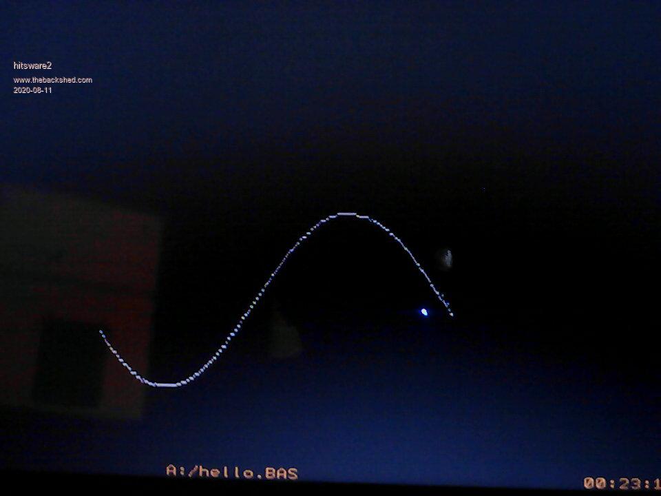

setpin 7, ain, 8 do while inkey$ = "" cls for x% = 300 to 555 pixel x%, 300*pin 7 next x% loop end ' ~ 45 Hz ( I'm sure ' there is a truth there ) ![]() my site |
