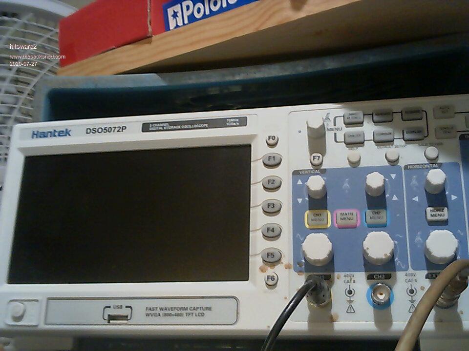

the 'competition' is something like a Hantek DSO5072P, which can be had for under us$200 on occasion. that price-point excludes PCB, display, user controls, etc.
i'm thinking of minimal hardware, minimal cost, with an application running on a PC to manipulate and display the output. the MX170 would be there to (1) be configured from the PC with things like sample rate, buffer size, etc, (2) be told to capture data to the onboard 50kpts buffer, and (3) return the contents of the buffer upon request.
the hardware of the oscilloscope would be the MX170, usb to serial bridge, and perhaps a single op-amp configured as a voltage-followed for analog input buffering. all plugged together on either a bit of veroboard or a solderless breadboard.
rob   :-)
Speaking of which :
my site
