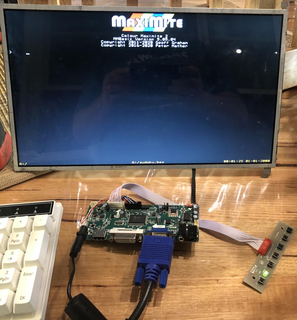

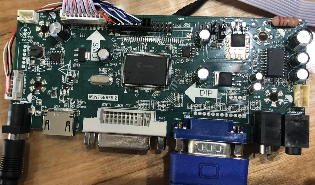

Hi Andrew,
I bought something like this to play around with an old laptop's TFT screen I salvaged..
VGA-Laptop screen
Note! I Didn't not buy that model specifically or know if that one even works... It is the `concept'.
I will try to dig out my screen and the adapter and try to take some pictures and see how it runs on the CMM2.
Kind Regards
Posts: 2981
Posted: 03:16am 01 Aug 2020
Hi Andrew, All,
Hey I found it and it works well. The yellow on the screen looks white but is actually beautiful colour as expected.
The board looks to be the identical one in my link also (that is always a plus)
I used a 15.6" screen I salvaged..
The beauty is the screen is so thin, it can be mounted on a wall or in a thin frame etc if you can get the bezel it even looks great but in my case the bezel was broken.
Kind Regards

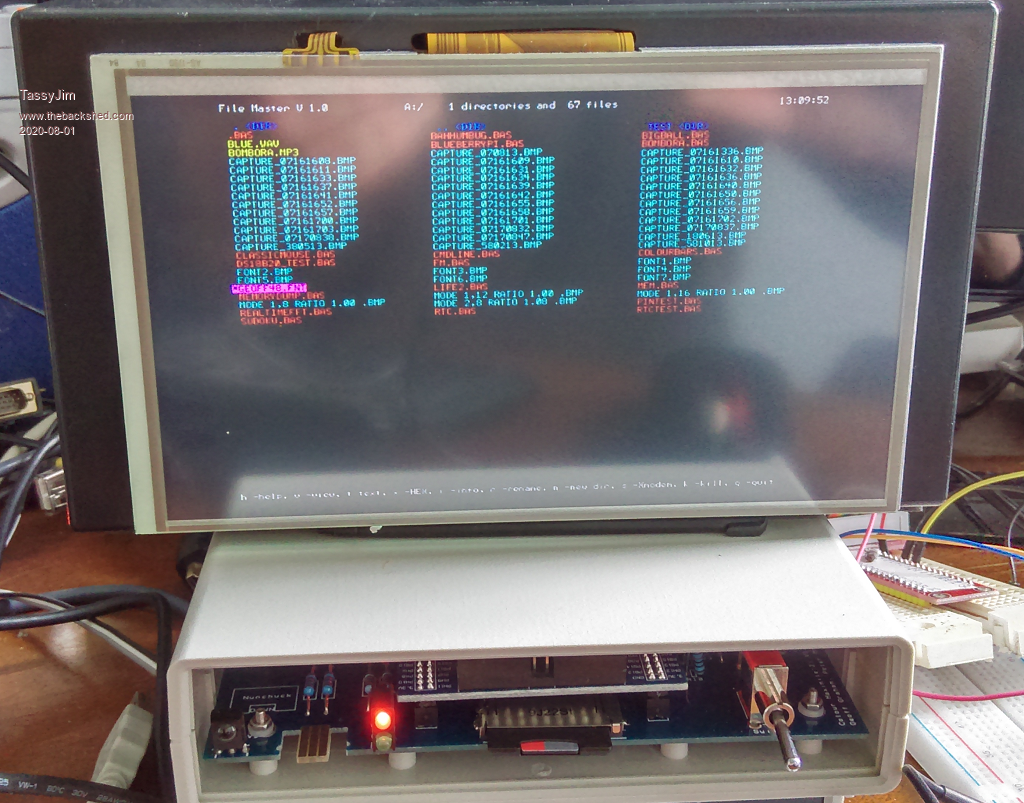

Posts: 6606
Posted: 03:18am 01 Aug 2020
I have a 7 inch LCD purchased for the CMM1 many years ago.
The display is sharp and steady but 800x600 is way too small for my eyes.
Other modes are fine and one day, I will get the touch working.
For the original, I did it by directly reading the x y resistances in basic but next time I will do it properly and use the touch IC.
There are plenty around that take VGA and HDMI as well as composite.
