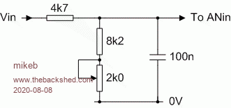

Hi all,
Let me start by saying this is the first time I have attempted to read voltages with an MM 28 pin.
I have two water pressure sensors  from Core electronics.
I am trying to monitor the water pressure of our stock watering system. I also would like to estimate when the pump switches on from the change in pressure.
A direct connection of the signal wire to an analogue pin seems to work BUT there are some data points which seem wrong.
What is the best way to connect up the sensors? I have read the section on analogue inputs (page 38 of MM manual) and am wondering if I can monitor analogue voltage pin.
All comments welcome.

Hi Rob,
The analogue input has an upper limit 3V3.
As your pressure transducer has a max output of 5V0 @ 1600 kPa you will need to use a voltage divider to limit your signal range to this upper level.
The following circuit will do this -
Mike B.

Thanks Mikeb,
I will implement that tomorrow. I thought I would be OK as the max pressure of the watering system is only 400kPa
Rob White

Hi Rob,
Have had similar problem. 3 things may help:-
1 Filter input. If the voltage will never go above 3.3V use same circuit as above but leave out 8.2k and pot, increase cap to 1ouF.
2 Filter Analogue Power. For 28 pin MM add 10 ohm between +3.3V supply and Pin 28 and 10uF from pin 28 to 27 (gnd).
3 Sample the input many times and take the average.

PS. One I forgot.
4. The sensor ground wire should go directly  to pin 27 (An Gnd). Make sure there are no other paths to ground.

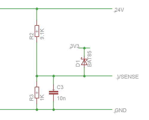

just as an aside.
I am a bit anal about the potential for voltages to exceed specs on pins so I always clamp to VCC with a schottkey diode just in case. They are pennies and if they are never needed, be happy. Better to have and not need than a dead processor.
In this example I am monitoring a 24V DC power line with a /10 divider... this could potentially exceed the 3.3V - admittedly if it does I probably have bigger problems but even so you get the idea.
Also, Phil's recommendation above about averaging over several samples will stop "surging" in value readings. I have a single function to read an analogue pin of my choice (this application has two AINs) and provide this averaging:

I average over 25 samples. I did test this and it seemed that any more than 20 didn't make much difference, so 25 gives a nice extra margin of stability, but ymmv.

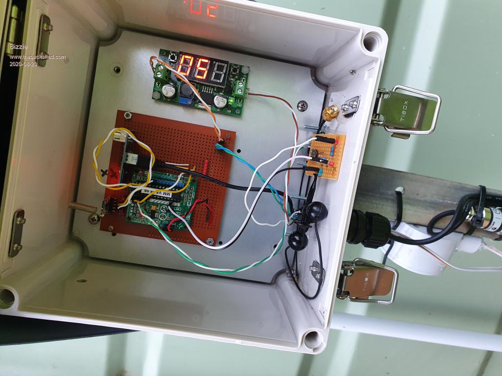

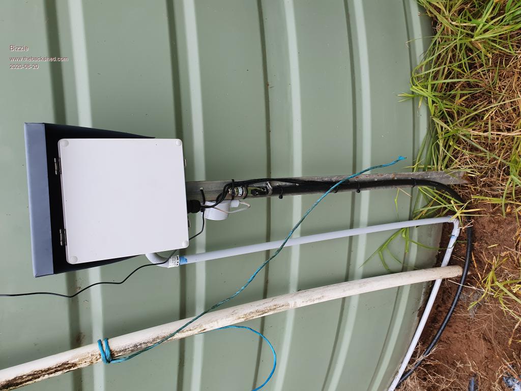

Here are two images (not sure how they got on their sides!) an overall shot and inside the box. The 20mm conduit supplies 12V dc while the large pipe is the tank filler.
Inside needs some tiding up work but contains a MM170 on one of Big Mick's boards, the depth sensor board sits vertically (ringed by the yellow and white twisted pair wires), The signal conditioning board lies on the bottom of the case at this time while you can see the HC-12 top left.
At the PC end there is another HC-12 and USB-Serial converter. Software wise I am running a VB.NET console app to communicate with logger, record the data and send the emails.
Thanks again all for your help.
