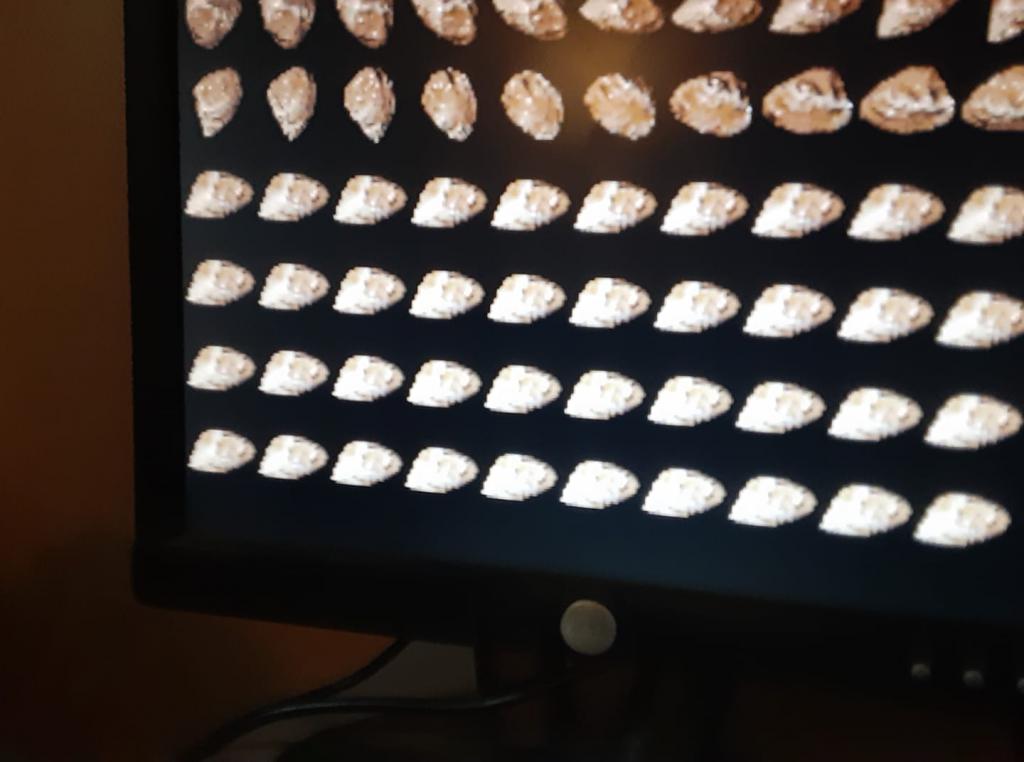

Hey all here's a link to a youtube video I did of an asteroid blit test.

It's incredibly fast. I had a similar experience the other day loading in streams of DATA and blitting the tiles to the screen. Again, had to slow it down, and slow down keyboard input too, to prevent reacting to the key press multiple times to scroll the data tiles..
I would be interested to see if you have any issues with transparency, as I notice you're drawing the asteroids onto a black background. I'm having issues with SPRITES erasing the page 0, despite being on page 1 ( in 12 bit mode)(probably something im doing wrong.. need to open a thread about it I think...)

you can set the blit to not copy transparent pixels, but then when they are spinning in place they won't erase the previous copy. I tried it with overlapping oids and they were masked correctly.
I wasn't sure how fast the blitting was until I tried it here. wow  Now I'm certain I can blit with color 0 removed  onto a fresh nebula on another page and blitted to page 0.  I'm working on a test for that, but I ran into a snag with loading pictures

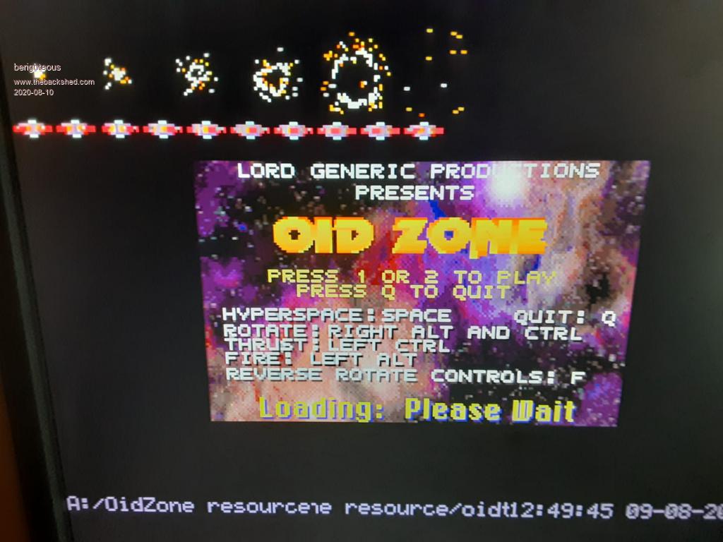

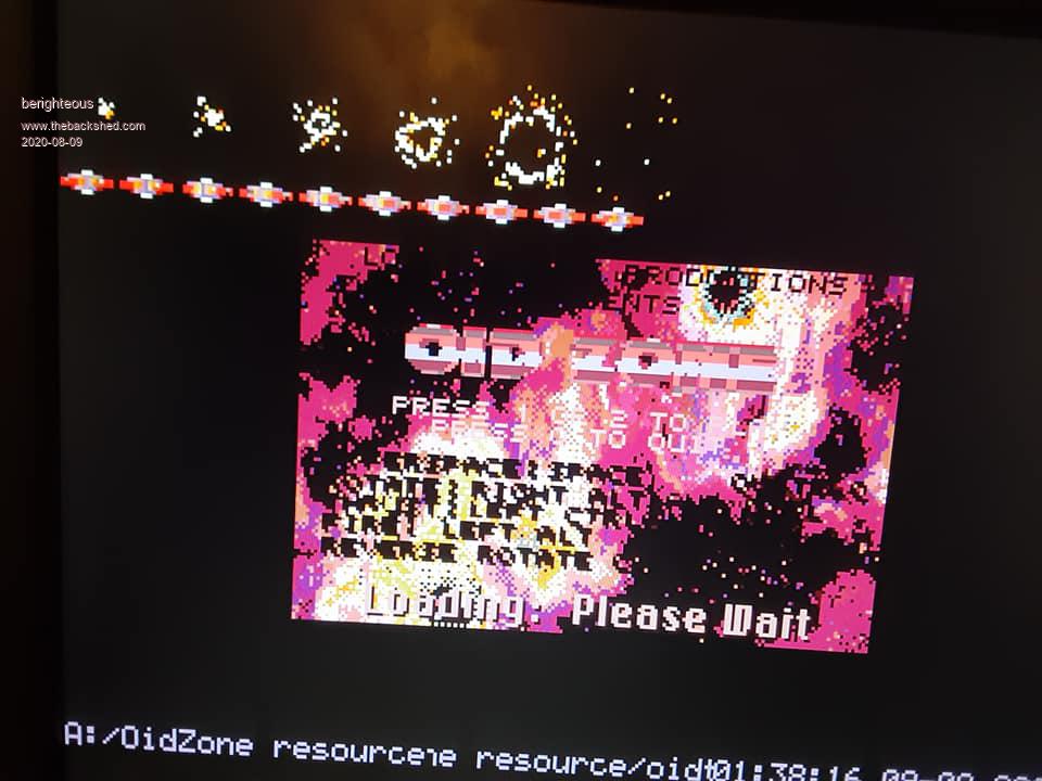

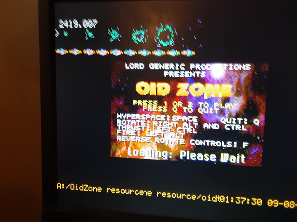

I have bmp and gif files WITH THE PALETTE I'm using, but when they're loaded THE COLORS ARE BEING REMAPPED TO FIT THE DEFAULT PALETTE INSTEAD OF THE PALETTE I JUST SET, so all the colors are wonky.  If I map reset, poof the gif or bmp I load looks right and all the other graphics on the screen have garbled colors. I would expect it should try and remap if it has to to the CURRENT PALETTE! Why can we set a palette if loaded art in the right format won't map to it? The picture are 8 bit specifically set to the palette I'm using. (I rechecked in photoshop and i'm changing the palette according to the photoshop palette file.) scratching my head on it.
S0 I have to go back to the original software I used 20 years ago to process those pictures like I did the sprites.  In the PC game I could just load the image and the palette and everything was fine.

I tried using MAP as well, when doing the PPU for my nes emulator. It was producing wonky colours for me too, so I wonder if this is actually a bug right now. Perhaps its reversing the colours. Try using B, G, R instead of R, G, B.. just out of curiosity.

no, it's definitely remapping the picture to the default palette. When I map reset all the colors on the screen change and the image colors pop back to looking exactly like it does if I load it without changing the palette.
Posts: 11875
Posted: 11:35am 09 Aug 2020
The BMP and GIF decoders know nothing about any colour mapping. They just convert the incoming data to RGB888 and that then is loaded to the screen using the standard RGB888 to RGB332 mapping. To do anything else would be unrealistic: for each pixel search the map table and look for the nearest match? using what criteria?

I then saved that index data into the data files I'm using now.  At the time (1996) I didn't convert the full sized images to that format because I could just load the bmp's in and change the clut on them on the fly because vga on the pc then just worked that way.
So I have a workaround for CMM2 not loading my images "correctly."  I searched the web and found the archives of the old euphoria language release I used to create the games originally.  I have to run them in dosbox now.  Then I can go back to the original euphoria programs that created my other data files, and I can make them load the 320x200 images into a euphoria object and then write out just the color index matrix to a data file, that I can read in my cmm2 program and have it look correct.
The downside is each of the 3 files I need takes an extra 3 seconds to process this way. Maybe I can make them sprites and save them and they'll load faster that way?

Posted: 08:59pm 09 Aug 2020
ok I processed the bmp using ancient vga secrets and created a data file of just the pixel color indexes and can load it in.  Tada!
