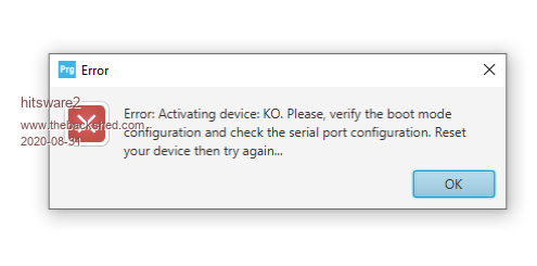

Thought maybe I could revive it with Windows , but :

I think you have 2 separate problems:
1. the dfu-util one that's hit other ST devices, as shown by web searches
2. something wrong on Windows
Judging by the SOLVED responses to #1 the board is OK (and may be partially erased) but ST have changed timeouts inside various of their CPU bootloaders and a patch to dfu-util fixes it.
I don't have an RPi setup connected to a CMM2 to do any testing but the SOLVED responses will likely work if you apply one or other of the patches.
For #2 (Windows), hopefully a Windows user will post ideas.

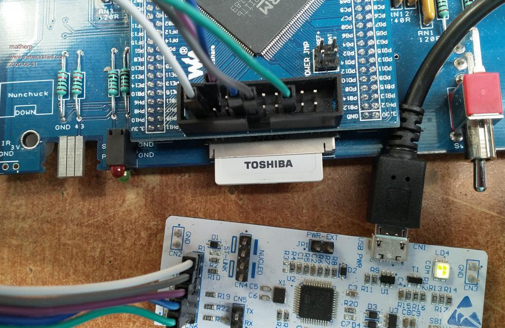

Posts: 11873
Posted: 09:09am 31 Aug 2020
If you or anyone you know has access to any of the ST Nucleo boards you can cross link the ST-LINK header to the Waveshare board and use ST-LInk to re-program
Edited 2020-08-31 19:22 by matherp

Hi,
I just updated from V5.05.04 to V5.05.05 via USB-serial (A-B cable) - not the Waveshare variant.
I also thought I had bricked my CMM2. I got the same error message (Activating device KO ...). But pressing the reset button (on CMM2) helped.
Best regards
Michael

Stupid question (Having just "bricked" my CMM2 (non-Waveshare) updating over A-B cable on Windows 10).
Where's the reset button?  Is it the thing on the top of the board immediately next to RS1 and C10?  If so, I'm not having much luck pressing that and turning everything back on.
Windows is still seeing a USB Serial Device so I'm guessing it's not fatal...
Edited 2020-09-14 01:44 by elk1984

Ok - got it back by plugging in a Type A to Type A connector, putting the jumper to Program and connecting STM32CubeProgrammer in USB mode.
Phew - that was close....
