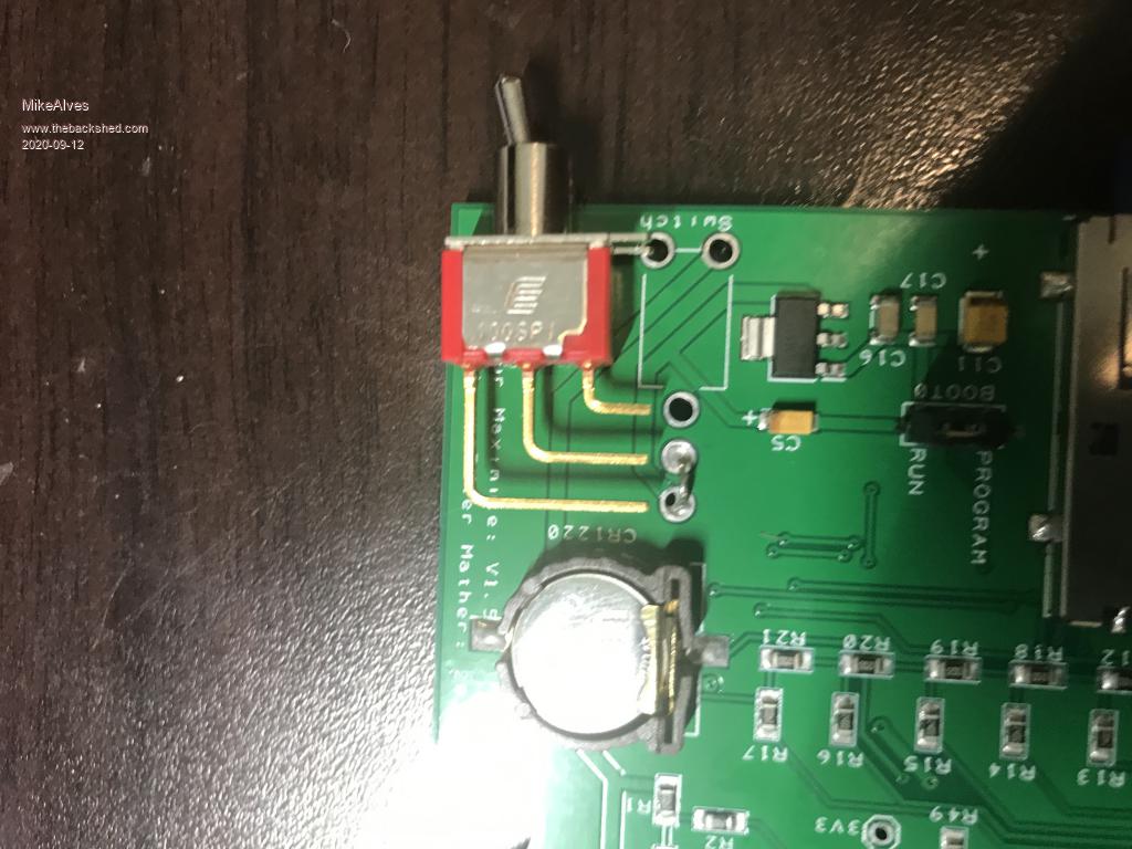

Hey guys,
I finally got my switch. Just to be sure, I remove the wire that bridges the two holes and solder the pins of the switch into the PCB (see picture)?
I am ok with a soldering iron, but I just don't want to mess this up.
Thanks,
Mike

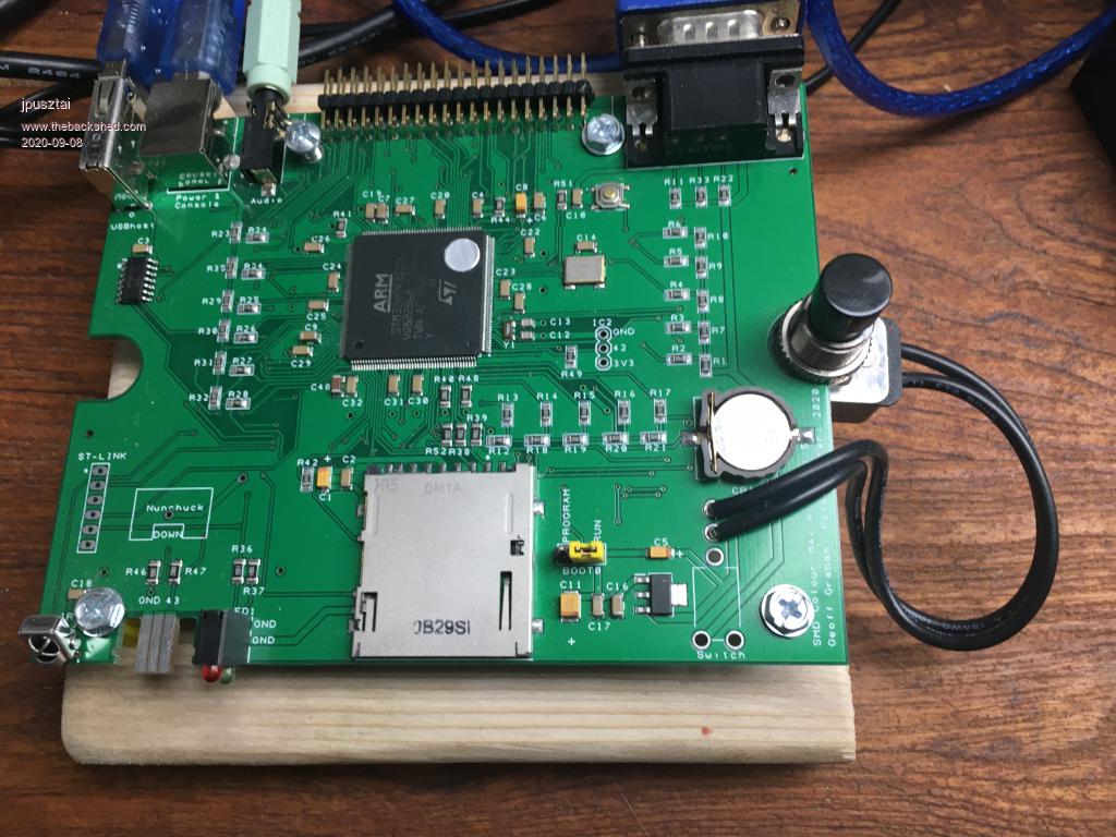

Mike, I can't see the picture, but "yes" - the switch needs to replace the "always on" jumper that came pre-installed on your PCB.
I used an old push-on / push-off switch I had lying around, and it happens to illustrate the point perfectly!
Edited 2020-09-08 10:28 by jpusztai

Here's the pic. I forgot to upload the picture. Am I lining this up correctly?
Posts: 6606
Posted: 11:02pm 11 Sep 2020
Yes
ON will be UP or DOWN depending on your switch.
