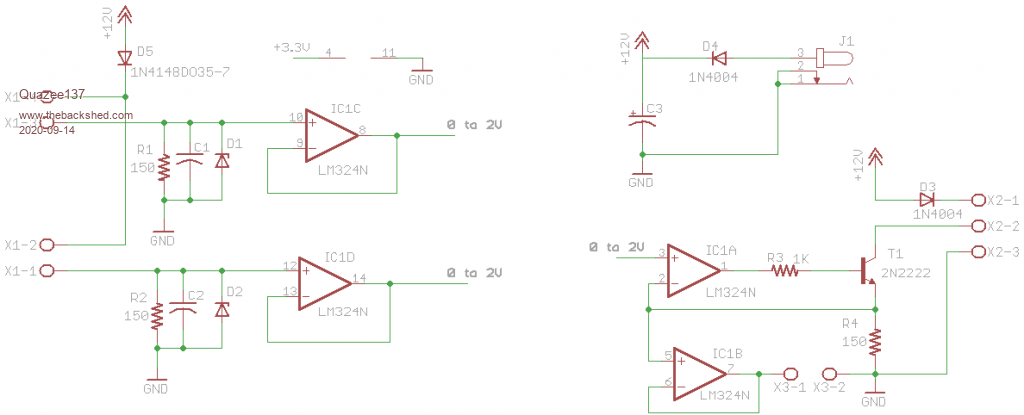

Hi Quazeee,
Using PWM on the MX170 is very simple. But the PWM output is a digital pulse (not analog voltage). You need to convert that digital pulse to an analog voltage, which can be done by a low pass filter. In simplest form a resistor and a capacitor. Values need to match the PWM frequency.
The PWM's in the MX170 MM2 basic are controlled with 0-100% value.
To get for 0V that is 0%, For 2V that is 60.6%.
I used the PWM in the "Backpack Tracker" project. The basis is:
PWM x,freq,value
For running PWM 1A at 100kHz, and 2V output, this is :
PWM 1,100000,60.6
Hope that helps ....

Here is whats left of the analog way. I cut out all the other op-amps doing
some basic adding/subtracting of the two inputs to drive the 4-20mA out.
I changed from 5V to 3.3V on the LM324. I wanted to change to the MM170 for
its display and touch removing four pots and trimmers. Also can do much more
math wise this way. Even setting different curves. I called it a 4-20mA mixer
at first but the need to have better control of how they are mixed/blended.
Made the analog way to expensive with 10 or 20 turn .1% pots and trimmers.
Using the MM170 will give more flexibility and having the inputs and output
displayed will be a major plus. Having touch for a menu system over the pots
will allow me to play with controlling/testing this in a smaller box.
Thanks Volhout for your help.

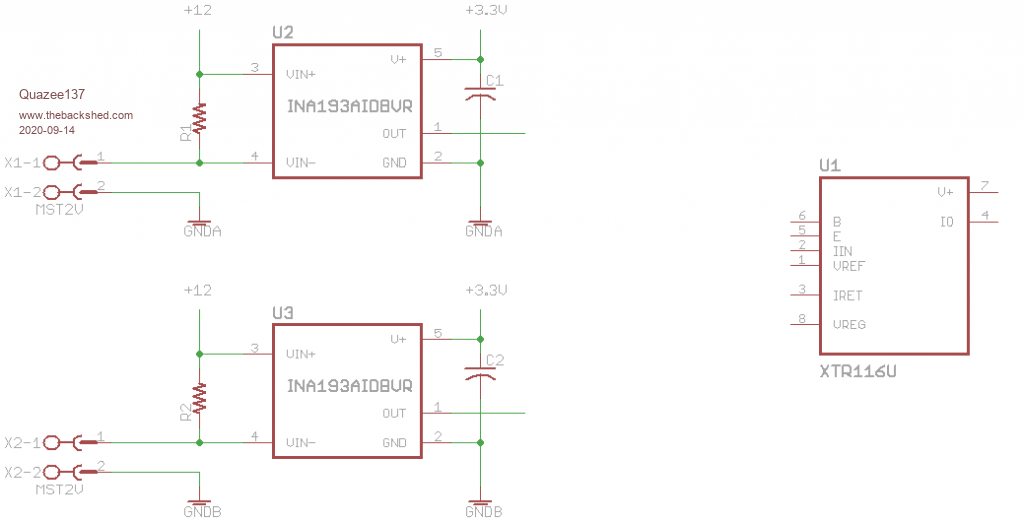

I am now looking at a newer way to do this these parts make it even smaller.
I could be making a MM170BP size board. Will need to get the 1.8 and 2.4 LCD
displays out and see if a smaller touch area will do.
Posts: 6116
Posted: 10:29am 14 Sep 2020
The XTR116 is not the most suitible part since it has a current input (not a voltage input), but I think we can make it work.
The upper circuit (opamp output = voltage -> through Rin convert to current) would give best linearity, but the lower one (PWMout -> low pass filter -> Rin) can also work if we dimension the low pass filter impedance correctly.
I would need to know from you what the fastest change is that you want to support in your circuit. i.e. 10msec, or 100msec. And the resolution (i.e. 10 bit, or 8 bit or...). Then I can calculate the filter and PWM frequency for the MM2.

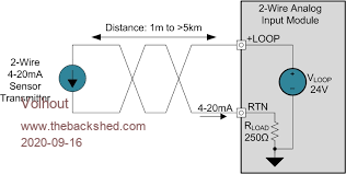

The industry standard for connecting 4-20mA sensors ties the + to 24V, and the - to a current sensing pin that connects to ground (exactly as your LM324 input circuit).
See this diagram:
Using this knowledge for the output circuit, we can avoid the isolating opto coupler if we source current (not sink current). In simplest form this would result in following circuit:
According to the MX170 documentation the PWM has 0.1% accuracy when the frequency is below 25kHz. So we pick 25kHz as PWM frequency. The low pass filter has a ripple that is 0.1% of the PWM input signal, in line with the accuracy.
The step response has a delay of 1ms for 63%, and is accurate within 1% at 3ms. That is way faster than the input will vary.
The current output (your LM324 circuit, only powered from 12V) feeds a current mirror (Q2/Q3), as a simple solution for sourcing current (not sinking). The transistors Q2 and Q3 should be thermally coupled for best performance.
There is one caveat: heat.
When powered from 12V transistor Q1 dissipates up to 120mwatt, but Q3 can dissipate 180mwatt. Using 12V you can replace Q2 and Q3 with one dual transistor, in which case the thermal coupling is perfect. For 12V Q1 can be an SOT23 2N2222, and Q2/Q3 can be a BC856S dual PNP transistor (ambient 25C, max 40C).
If you use 24V, the dissipation in these parts more than doubles, and you need the transistors (or similar) as shown in the schematics to get rid of the heat.
If needed a circuit can be designed that does not use the current mirror (less dissipation), but that will require another opamp. I understood you wanted a compact circuit. This is as compact as it gets...

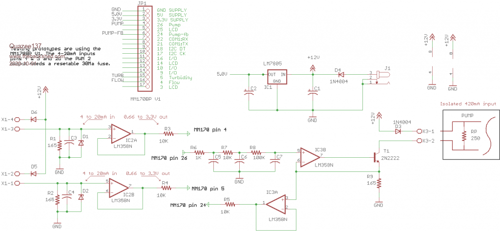

Volhout had time to breadboard the basic PWM to 4-20mA output and two 4-20mA
inputs along with a bit of test code to play with.
Here is what I am playing with. Things are working. Next adding resetable
fuses to the three 4-20mA I/O's. Still unpacking from move in March. I have
a box with a few MM170BP's V1 with 2.4" and a few of Mick's boards that should
have the one more needed AIN for monitoring the output if/when driven from the
pump.
Thanks again for your help.

I think resetable fuses are a good idea. But they are thermal devices.
In case one of the sensors becomes a short, the LM358 get's 12V at it's input (it will survive). It's output will also become +12V (actually more like +10.5V). But it will be capable of driving substantial energy into the MX170 analog inputs.
I suggest adding a 2.2k resistor in series (from LM358 out to MX170 in), so the current never exceeds 5mA. That will keep your MX170 alive.
P.S> the series resistors are always nice to have, since they are great jumpers... Makes layout a lot easier.

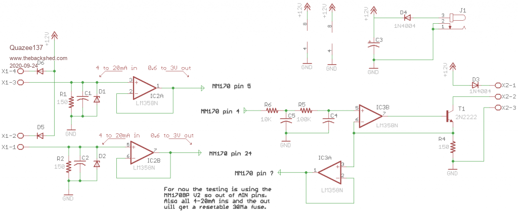

 I have a prototype up and running. I ordered 3.3Volt zeners but they are
not letting the input voltage above 2.4volts.
Here is the latest work
and the testing display
The LM324 / LM358 I have used to read 4-20mA before. Till now did not
have a need to output 4-20mA. Your help has given me more ways to go using
the MM170.
I am using the inputs to index into a table of 2,145 data. The + - touch
buttons are to shift the pump data from the table by a few percentile till
we get enough data and modify the table. Now it is raw F/T to pump lookup.
Having FUN

I knew about the zener diodes. Especially the low voltage parts have a very weak cutoff point that starts early. What I normally do is use 1 of those zeners and a pullup resistor to create relatively hard 3.0V. And use 1N4148 diodes (these have low leakage) to clamp inputs agains that 3.0V. Resistor 500 ohm or 1k to +12V.
When do you transfer from the desk to the actual industrial plant ? That is going to be FUN...
b.t.w. I understand what you changed the 150 ohms to 165 ohms at the input circuit to exactly map the ADC onto 0-20mA. I suggest otherwise. I always keep some headroom, so you can detect faults. If the current exceeds 20mA (bad isolation or bad sensor) your ADC will measure 20mA. With 150 ohms you will be able to detect the fault since you would measure 22mA, and see that it is out of range. Similar, if you measure 0mA, there is a wire break.

Posted: 09:01pm 02 Oct 2020
I put 5.1V zeners in for now it should keep the input from going to 12Volts
