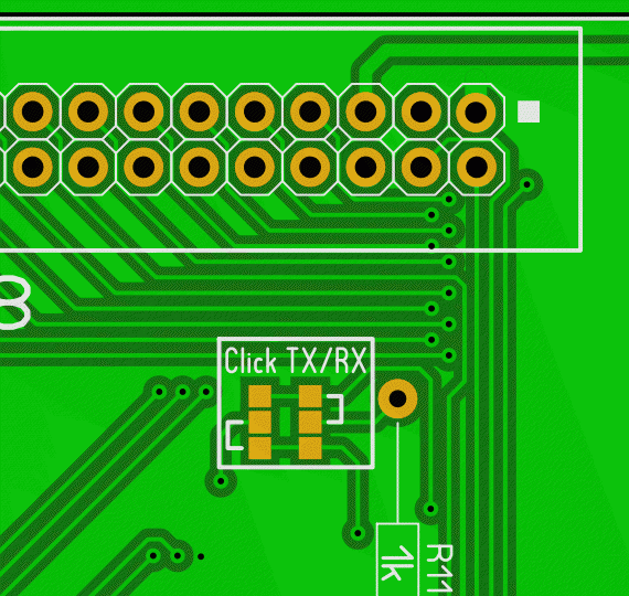

Please take note of the little solder-blob pads on the E100 boards to route the COM port signals:
These solder-blobs MUST be in place, for COM3 to work on the CLICK sockets - MUST be.
These little blobs do not affect CON8 though, and COM3 is routed there without the need to solder blob, but if you are trying to use a CLICK module....
The silkscreen shows the standard routing, but the little pads were put there, as at the time of design, neither I nor Geoff could be sure of what polarity the CLICK modules serial was.  "TX" and "RX" with respect to which end?
So we put those pads on the mainboard, so that if we discovered it was wrong, it was an easy fix to simply move the solder-blobs.
BUT if you DON'T install them, there will be no link to COM3 on the PIC32 if you are using a CLICK module.
Geoff's post explains why we did not route COM2 to the 2nd Click module.  And I agree with him - hindsight is a wonderful thing.  If there is ever a new version of this PCB, I will make that change.

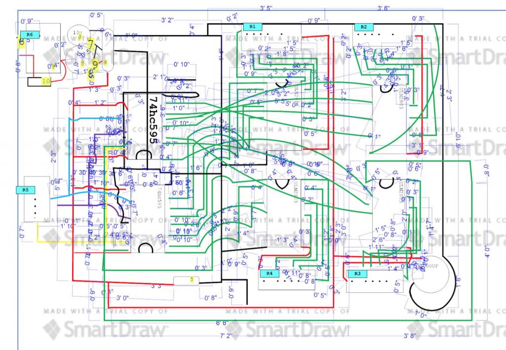

Problem with TX meaning 'data out from me' and confusing it with '[I am Rx so] connect me to the TX of the other side' is that multipage circuit diagrams will usually have 'ports' (ie: arrows, or simply 'dead-end' wires) with labels on them. To make TX and RX work you have to connect the "TX" port to the "RX" port on the other chip, and that goes against everything we've learned about how to interpret circuit diagrams!
To save any confusion it is always nice to add a text label near to the 'port' saying exactly what it is. But I like verbose circuit diagrams... especially like the following...
From the arduino forum.
Posts: 3879
Posted: 01:35pm 27 Sep 2020
  MustardMan said  But I like verbose circuit diagrams... especially like the following...
LOL. Might as well provide an EagleCad "Air Wire" image.
