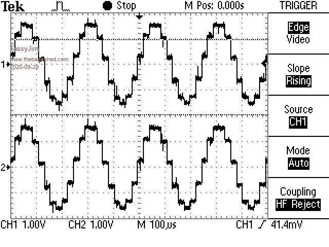

Morning all. I am trying to do a wave generator to test a new CRO, but the DACS on my CMM2 have me puzzled. I can brute force the DAC to produce a lovely smooth ramp wave (or whatever), but if I use Play Tone or Play Sound the output is a dreadful 5 step mess.
Can find no other way to adjust the DACs. Am I missing something?
Am using a newly flashed 5.0505. Cheers, Dave

Posts: 6606
Posted: 07:20am 29 Sep 2020
Thanks.
I agree.
The output seems to be set at 25uS intervals, independent to the frequency.
It's a while since I have played with the audio so I am not sure when this problem appeared.
Posts: 11873
Posted: 07:28am 29 Sep 2020
This has always been the case. That is how tone generation works. Same as on all MMBasic versions. Can't find the reference but the technique uses a constant frequency interrupt and then picks the appropriate place in a sine table for the next sample. The interrupt frequency on the CMM2 is 44100 Hz. Because other MMBasic versions use an RC filter on a PWM output the sine wave will look smoother but the technique is the same

Posts: 6606
Posted: 07:59am 29 Sep 2020
Thanks for the info Peter, I hadn't noticed it before and the audio is OK, just looks rough on the CRO.

William Leue
Joined: 03/07/2020
Posts: 411
Posted: 03:24pm 02 Oct 2020
Just put a small capacitor between the output and ground to filter out the high-frequency components of the waveform to smooth it out. You will have to experiment to find the right value. I would start with something like 0.05 microfarad.
