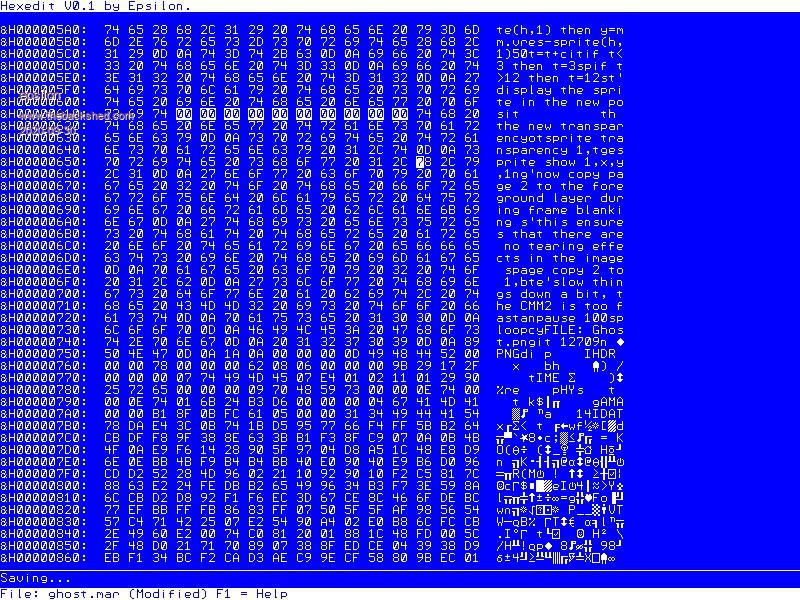

Hi all,
I made a hex editor for binary files. See description of the tool below. I hope that some of you will find it useful.
I might derive a memory editor (a peek/poke front-end) from this once the dust has settled.
Feedback is welcome of course, in particular if you find that some key bindings aren't working correctly. I have a Belgian keyboard, which is not supported. I have it currently configured as a french keyboard, which is not a perfect match, some I'm not 100% sure I got all key combos correctly. Let me know please.
Any other feedback is welcome too of course, including coding practices.
GitHub: https://github.com/epsilon537/hexedit_cmm
hexedit.zip
Cheers,
Epsilon.
Description
HexEdit allows you to edit binary files, i.e. files that you can't edit with a regular text editor such as the built-in editor.
The file's contents are shown as hexadecimal byte values and as ASCII code in two side-by-side blocks. Changes can be made both in the hex table section and in the ASCII section.
The usual file navigation with cursors keys, page up&down, home, end, etc. should work as expected.
Hexedit is a full-screen console-only editor. I does not work over serial, sorry.
Press F1 to get help on key bindings.

This is great! I'll have to take a look at it after work.
  Quote  Hexedit is a full-screen console-only editor. I does not work over serial, sorry.
Out of curiosity, what was the reason for not working over serial?
Was it because of screen positioning, the use of the modifier keys (alt, control, shift, win/gui), or something else?

The reason for not working over serial is laziness mostly
I'm using some graphics functions: a line across the screen, the help pop-up is a sprite...
The footer line is also continuously being updated to reflect current status, which doesn't work well over serial, unless you make it a bit smarter probably.
Full-screen updates such as page scroll are also a bit slow over serial depending on your baud rate settings.
Anyway, nothing fundamental. I'm pretty sure the tool can be made to work over serial. Modifier keys appear to work over serial.

Hi epsilon,
as always: good job! A useful tool. The code is crystal clear. Thanks!
Some comments:
I think the memory is being used too much.
I cannot start the program with "Option RAM" (which I usually work with). With "Option Flash" I cannot open the help popup (F1).
  Quote  Error in line 487: Not enough heap memory.
Some ideas (only if desired):
1. You could reduce BUF_SIZE% (e.g. to 70000-75000).
2. You might add a decimal mode.
3. You could check if "Long Strings" are an improvement. You are giving away half of the memory space with "fileBuf$ () LENGTH 1".

Thanks Michael. Good feedback!
I'll make sure the tool works with those options.
1. I intend to add support for arbitrary long files through some kind of paging mechanism, so I can set BUF_SIZE smaller without limiting functionality too much.
2. I was saving that for decedit. Just kidding.
3. Yes, I think I may switch to long strings, at least for the 'modified' array. It's really just a boolean array, so having a string length[1] array for that purpose is 16x more wasteful than it has to be!

I might do that. At 8 bits, the limit is at 1600x1200 = 1.875MB. That's good enough for my purposes here.
  vegipete said
Could non-printing characters on the ASCII side be displayed as "." instead of " "? They would be easier to see on screen.
Will do. Thanks for the great feedback!

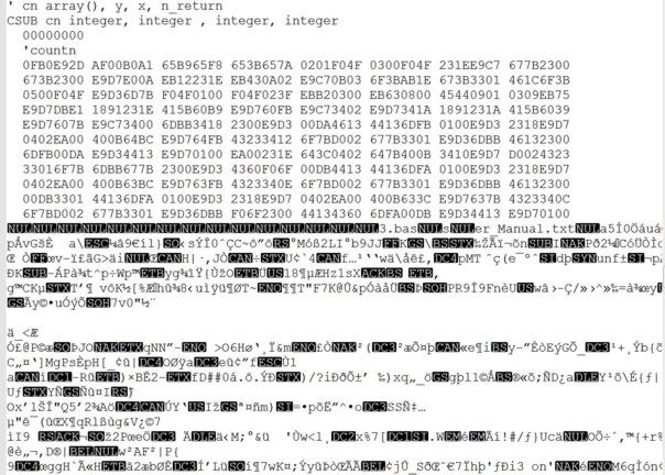

I think a useful feature would be to save parts of a file to repair corrupt files (CMM2 bug) without using a PC.
The file size is not that important (<100KB usually).
Michael

I uploaded V0.2 to GitHub:
I also put a link of Fruit of the Shed.
These are the changes:
- Documentation updates.
- Fixed error 'Function name + variable name must be less than 33 characters'.
- Using "." instead of " " in ASCII block locations past file size.
- Using "?" instead of non-printable characters in ASCII block.
- Fixed program crash when insert is pressed.
- Added Loading..., Inserting..., Deleting..., Filling... indications.
- Fixed heap memory issues.
- Increased File Size Limit to 1.6MB
Using integer array as well as framebuffer to fix the memory issue. Thanks again for the suggestion.
