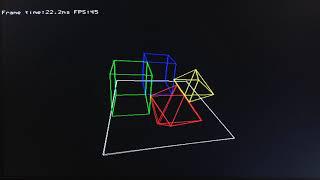

I'm creating an API for 3D rendering. For better performance probably I'll port it to CSUB on the final version.
In this example I'm rendering 5 objects at the same time
There is a lot of work to do.
What do you think about the API structure?
Video
The source code: https://github.com/.../colour.../blob/v0.3/api-3d.bas

Nice work - I was thinking about something similar but the bit you are missing and I couldn't work out how to do is handling hidden lines. Perversely this is much easier with solid objects (Painter's algorithm) than with wireframe.
Link to your code isn't working

IIRC (my 3d maths are a bit rusty), but if you compute the surface normal of the faces, and compute the dotproduct of that and the camera normal, any negative values are facing away from the camera and could be skipped in the drawing phase (backface culling).
This assumes no transparency in any of the faces (ie, wireframed faces are solid and not see through), which I assume is what you are after.
Also, looks like github link is here: https://github.com/leonicolas/colour-maximite-2-examples/blob/master/api-3d.bas

For information, I typed up some notes on how to do it on the Facebook page. I've pasted the info below.As mentioned, it works great for convex shapes with no overlapping faces, but the moment you need to obscure one surface with another it breaks down. However for a game like BattleZone this would be fine (there might be slight errors with the gun and the turret, but nothing major).
My code is here:
https://www.thebackshed.com/forum/ViewTopic.php?FID=16&TID=12868&fbclid=IwAR1Pl0gHcZrBW4UeZqyPjMeCTgHb6usO4IjzvgrE_xH1gaHWW5rFIEdH1nQ
The planes (i.e. surfaces) are made up of vertexes (points in 3D space).
So, the Vertex/point below is Vertex#0 and it is x=32,y=0,z=76
Defined in code as:
vertex(0,0)=32:vertex(0,1)=0:vertex(0,2)=76
A plane is defined as 3 or 4 vertexes. In the case below, plane 6 is made up from Vertex 5, Vertex 3 and Vertex 1.
Defined in code as:
plane(6,0)=5:plane(6,1)=3:plane(6,2)=1
The ordering is important. If you were to draw out this 3d model and you numbered each of the vertexes - when you look directly at that surface you would see that points 5, 3 and 1 appear in a clockwise rotation. It doesn't matter which point you start at, just the order in which they appear, so I could easily have defined this surface as point 3, 1 and 5, and it would still work fine.
The cross product is just a quick calculation that finds a vector pointing out from the plane. If we were to do this on the model and plot these cross product vectors, the model would look like a porcupine with vectors sticking out of each surface.
However, if you were to record the points the opposite way (anti/counter-clockwise) then you would have 1, 3, 5. This technically defines the same surface, however if you calculate the cross product of this plane, the vector would point in towards the center of the model.
This is why I say the order in which you use the vertexes to create the plane is important.
So, we have this cross product vector for every plane. In my program, x is horizontal, y is vertical and z is into and out of the screen (depth).... i.e. z is either facing towards the viewer or away.
If you imagine this vector sticking out at right angles from each of the planes.
If the Z part of the vector is positive, then this cross product vector is pointing towards the viewer (i.e. the surface is visible). If it is negative, then it is pointing away from the viewer (and therefore the surface must be hidden/behind the rest of the object). Think of a plane facing you with a vector coming out at right angles. As you rotate it around, the moment the Z part of that vector passes through 0 and into the negative, the face has effectively turned away from you.
This is one of the tricky concepts. We are used to 3d shapes being solid, but using this method we can have weird shapes were some parts of an object are only visible when facing the viewer. For my Elite ship, it only looks solid because we have a complete ring of surfaces which all connect seamlessly. If you remove one of those surfaces, you will not see the surfaces behind it, because they are pointing away from the viewer. You will just get a gap in the image.
So, the final step is just to work out what the cross product is. Well, it's a pretty straightforward calculation.
We need two vectors from the plane to calculate the cross product. To use the above example, where plane/surface 6 was made up of points/vertexes 5, 3 and 1. Given that a vector is simply the distance between two points. Vector1 is the difference between points 5 and 3 and vector 2 is the difference between points 5 and 1.
Given two vectors vector1 and vector 2 (i.e. 3 points on a plane), we use the following formula.
If Vector 1 is defined as (dx1,dy1,dz1)
and Vector 2 is (dx2,dy2,dz2)
then
crossX=dy1*dz2-dz1*dy2
crossY=dz1*dx2-dx1*dz2
crossZ=dx1*dy2-dy1*dx2
Which means the final cross product vector is defined as (crossX,crossY,crossZ).
Of course, because we only actually care about the Z part of the vector, we don't need to calculate the first two parts.
IF CrossZ > 0 then we plot it because it is facing the viewer. If it is negative, we do not plot it.
Does any of that help clarify what I'm doing?

I'll implement in a future version a hidden faces algorithm, but for the current source state I'm trying adding more features and fix the current issues. I need to fix the translate x rotate center issue and I would like to add the object scale sub routine.
Pette Cotton is help me with the hidden faces algorithm.
We are thinking to port Elite game to the CMM2 and a wire frame 3D API is enough to do it I guess. Does Elite use solid objects or only wire frames?
