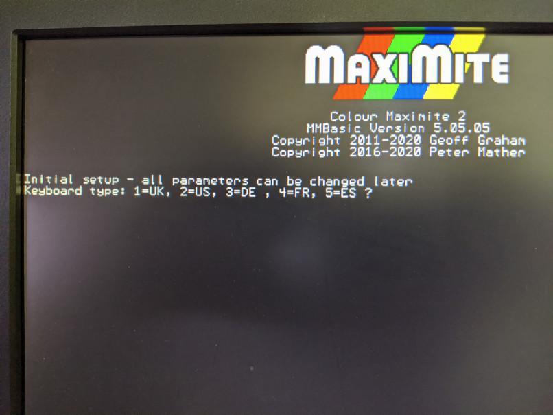

About 50% of the time when I type OPTION CONSOLE SAVE the CMM2 reboots and enters initial setup mode and loses all of my settings. At first a low battery was suspected but I measured it with a multimeter and it's strong at 2.95V. Other times it enters initial setup mode when I first power on.
Could this be a bug?
I'm running 5.05.05

Do you have anything connected to pin 40? If on startup the system thinks pin 40 is low it will reset OPTIONS.

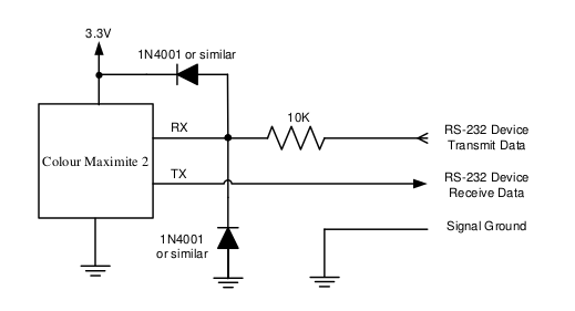

Nope, pin 40 is disconnected. The only connections I have going to the expansion port are the RS232 circuit described in the manual, connected to COM2.

By "Initial setup mode" do you mean that it asks you to set the date and time or do you just loose your saved options?

  TassyJim said  By "Initial setup mode" do you mean that it asks you to set the date and time or do you just loose your saved options?
The prompts asking for my keyboard region (UK, US, etc,.), the time then date. And all options that I usually change like repeat rate, disabling the serial console, etc, are  reset to defaults.

  matherp said  Replace the battery - almost certainly the issue. If you have a Waveshare based system make sure all the jumpers are removed
What's strange about it though is that it hasn't actually lost the settings.
I just noticed that if I power cycle it instead of entering the requested information,  on subsequent reboot it will still have the previous time, date, and options remembered from before. It's like the routine that checks for the RTC and OPTION ram info is failing sometimes.

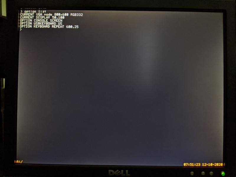

What options do you have set - please post a screenshot of OPTION LIST

What version are your running? Try setting the keyboard repeat to >25. There was a bug in some earlier versions with this

Load the latest version on the end of this thread  and see if the problem still happens. If it does then there is an electrical issue somewhere. The firmware checks the option area for valid data and only enters the initialisation sequence if it finds the option date invalid.
As long as the battery is OK it should always be valid after the first time. Which board are you using? Waveshare or all-in-one? Who made it?
To be pedantic, only set the keyboard type you are using and the time, don't change any other options and see it the issue still occurs
