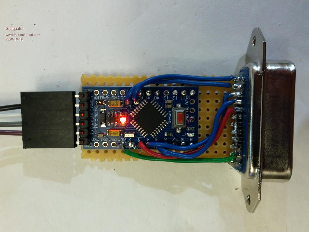

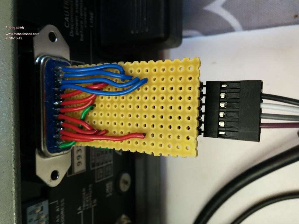

Ok, I built a prototype of the interface described in the link Rob provided above.  It needs more testing, but so far is working great!
I used a China knock-off Arduino ProMini (ATMEGA328, 5V, 16Mhz) This model does not have any USB functionality built in which is not needed for interfacing by serial port, but I did need a FT232 breakout to program the firmware.
The Arduino ProMini was $3.20 USD delivered to my mailbox.  The 24pin IEEE488 connector was $3.48 keeping the total cost well under $10.00 USD!
Note that the connectors are often listed as "24pin SCSI" or "24pin Centronics" although this is probably not really accurate.  I used a "Male" connector as instruments all have a "Female" connector on the back.  This allows the interface to be directly connected to a single instrument or a standard IEEE488 cable (or stack of connectors)  These connectors do not use 0.1" (2.5mm) spacing so they aren't really breadboard friendly.
I had expected to spend a few days sorting out all the hardware and software etc. But this project is really complete and well thought out.  If you are looking for an interface to IEEE488 (GPIB) instruments, I think this is a valid and low-cost method.
Here is the top of my prototype showing the Arduino ProMini and some of the wiring:
Here is the "bottom" of the prototype showing the bulk of the wiring to the connector.  There are 8 data lines, 8 Bus-control lines and a couple of grounds.
I plan to build another using the Arduino ProMicro (ATMEGA32U4, 5V, 16Mhz) which has built in USB port for use with PC/MAC etc.
