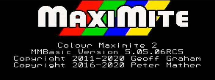

  matherp said  V5.05.06RC7 now available for download
Many thanks for this Peter, excellent work as always.
Just one comment, I downloaded and installed the firmware (twice) and the splash screen and TerraTerm still list this as v5.05.06RC5.  I flashed the firmware twice just to make sure I had the right version, and checked the file was CMM2V5.05.06RC7.bin
Womble
twofingers
Joined: 02/06/2014
Posts: 1769
Posted: 01:04am 29 Oct 2020
  Womble said  ...
Just one comment, I downloaded and installed the firmware (twice) and the splash screen and TerraTerm still list this as v5.05.06RC5.  I flashed the firmware twice just to make sure I had the right version, and checked the file was CMM2V5.05.06RC7.bin ...
The splash screen should show v5.05.06RC7!
If not, you made a mistake in the flash process.
Please check the correct path here:
Michael
Edited 2020-10-29 11:16 by twofingers
The lone and ...

My splash screen shows RC7. So far, so good.

Someting wierd going on here. I checked ... and flashed it twice with a known good USBA-A cable using "Update Firmware" as per normal.  Done this lots of times.  Doublechecked and I downloaded the zip file containing CMM2V5.05.06RC7.bin using the link above.  Both times the splash screen was wrong.
Time to redownload and try again.
Womble
Edit:
Redownloaded from Peters post above:
Followed the instructions in the Manual.  Connected USBA-A cable, Update Firmware (entered via terraterm), disconnect USBA-B cable, Run STM32CubeProgrammer, load correct file and verify.  Here is my logfile:

SUSSED IT
03:05:06 : Time elapsed during the read operation is: 00:00:00.005
03:07:28 : Read File: C:\Users\Womble\Desktop\Colour Maximite 2\CMM2_Construction_Pack\CMM2_Beta_V5.05.06RC7\CMM2V5.05.06RC7.bin
03:07:28 : Number of segments: 1
03:07:28 : segment[0]: address= 0x0, size= 0xBCDC8
03:07:33 : Memory Programming ...
03:07:33 : Opening and parsing file: CMM2V5.05.06RC5.bin
03:07:33 :   File          : CMM2V5.05.06RC5.bin
03:07:33 :   Size          : 761544 Bytes
03:07:33 :   Address       : 0x08000000
I just tried again (4th time did the trick), turns out that although I had loaded the correct firmware file in the "Read Files" tab the programmer was changing it back to a previous version under the "File Path ... Browse Files" button.
I had not noticed because my file path was too long.
Change this to select the file again and Bingo, it worked.
My Bad ... Thanks for all your help
Womble
NB. Wombles have Kapok for brains and can be a bit thick.
Edited 2020-10-29 13:45 by Womble

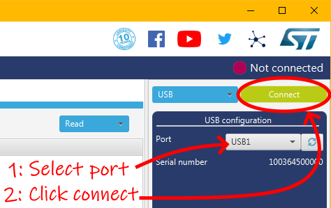

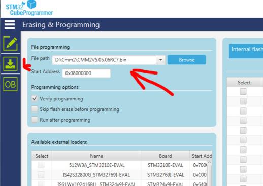

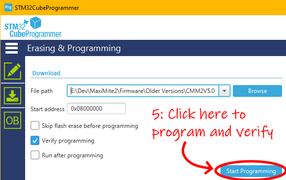

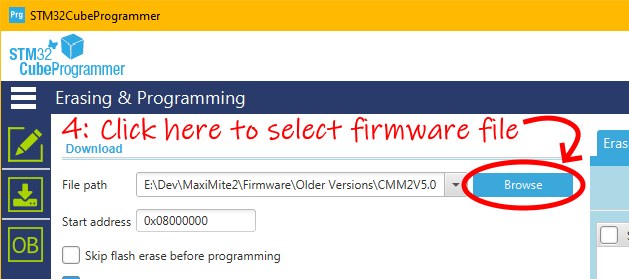

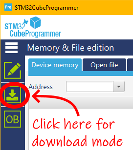

vegipete
Joined: 29/01/2013
Posts: 1185
Posted: 06:07pm 29 Oct 2020
  Womble said  I had loaded the correct firmware file in the "Read Files" tab
This caught me out too before I got the hang of things. Perhaps the following will help remind me in the future:
Updating the firmware on your Colour Maximite 2
You will need the STM32CubeProgrammer software.
Follow the instructions at the end of the Colour Maximite 2 (CMM2) User Manual. Included here are some more images with bright red arrows and text to help you. Don't panic.
A) Put the CMM2 into update mode (different methods, including "UPDATE FIRMWARE" or BOOT CONFIG switch or jumpers or ...) and connect to computer. (If you use the USB jack on a Waveshare board that is still plugged into the main board, the keyboard must be unplugged.)
B) Run STM32CubeProgrammer, select port and connect
C) Switch to programming
D) Select firmware image file
E) Write the new firmware to the CMM2
When successfully finished, click "Disconnect" (Connect button in first image above), power down the CMM2, set any jumpers or switches back to normal, connect cables as normal and turn it back on. Confirm correct firmware version on the splash screen. Set any desired options.
(Then do it all over again because matherp just released a new version ;-)
