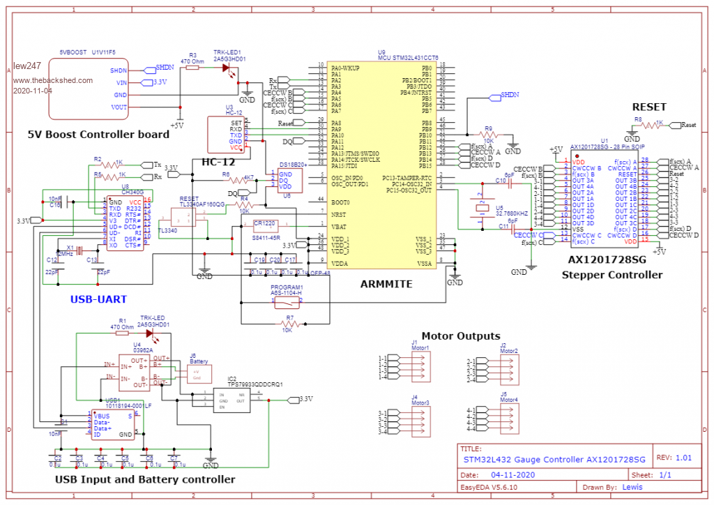

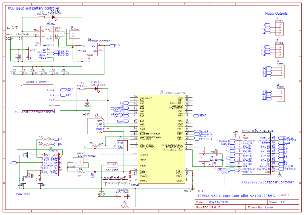

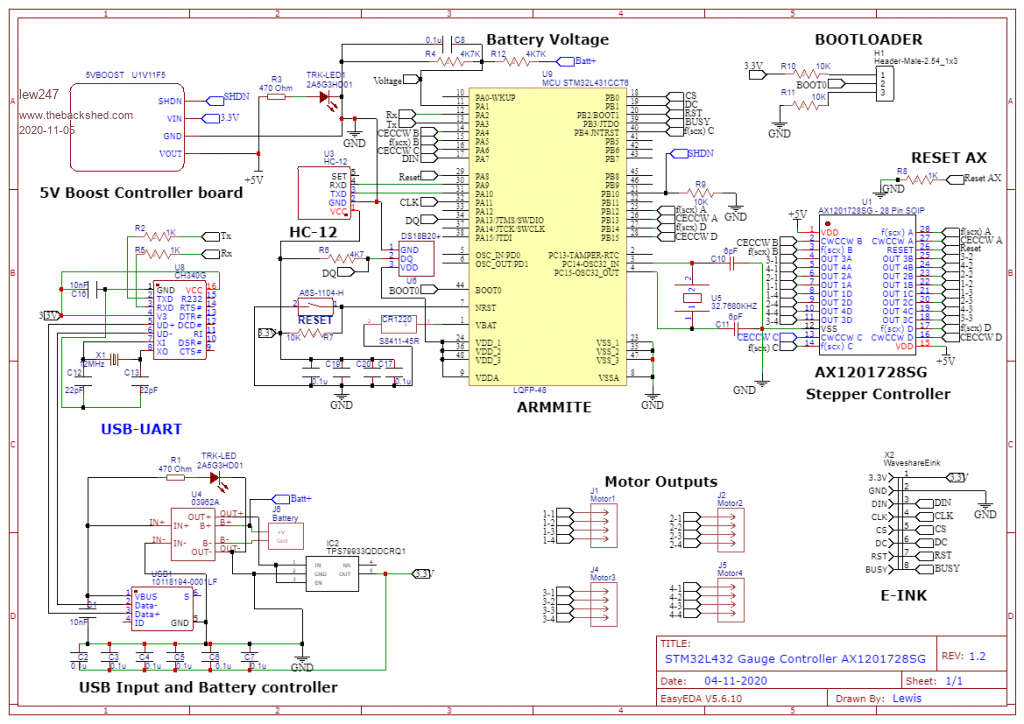

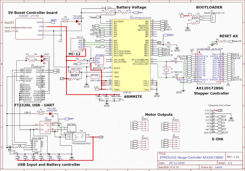

Would people be so kind as to check my circuit and see if you can spot any mistakes please?
It's for an STM32L431CCT6 driving an AX1201728SG stepper motor controller
It has USB to Uart, 5V boost converter, HC-12 and DS18B20 as well
Hopefully I've got the circuit so it can be used both as a console and programming via usb
Schematic.pdf
Posts: 3879
Posted: 02:12pm 03 Nov 2020
I can't judge overall, but where is your SHDN line coming from?
To satisfy curiosity, what is the application? [EDIT: Oh, I see it's for your gauge control task.]

Well spotted
It "will be" coming from pin 43
I just learnt to check what is being deleted when you press the delete button
Deleted the whole project! have to start again from scratch
Thankfully I can use the pdf I just downloaded from here as a basis to start again

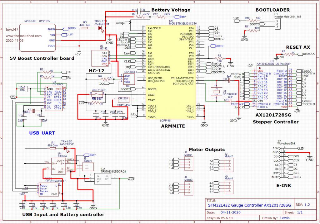

Posts: 6116
Posted: 04:03pm 03 Nov 2020
C187... C20 do not gave ground connection
reset switch connected wrong (R4 to pin 7, switch pin 7 to ground)
CH340 pin 1 not connected to ground
U1 RESET pin should have a resistor to force reset when power applied until STM32 executes code. Same for SHDN pin. The boost convertor should not start until the STM commands.
U2 pin 2 (GND) not connected to GND
Maybe add a jumper to HC12 pin 5 (SET) so you can configure it from the STM32.
USB1 connector seems to have a connection between pin 1 (Vbus) and pin 5 (GND), and neither is connected to GND.
C10 and C11 do not have connection to GND.

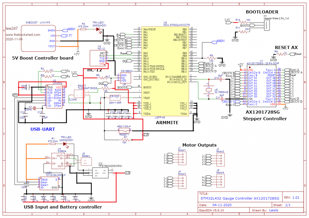

lew247
Joined: 23/12/2015
Posts: 1709
Posted: 11:31am 04 Nov 2020
Updated and I "think" it's all correct
but I stand to be corrected
Schematic_New1.pdf

Posts: 6116
Posted: 12:16pm 04 Nov 2020
This does not make sense to me (RESET hardwired to gorund)
Also R7 and PROGRAM1 must connect to BOOT0 pin on STM32
R1 should connect to IN+, not IN-
Edited 2020-11-04 22:17 by Volhout
lew247
Joined: 23/12/2015
Posts: 1709
Posted: 01:14pm 04 Nov 2020

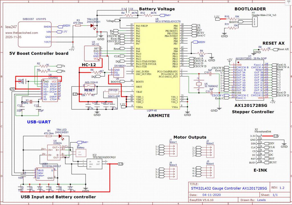

Think I've fixed the issues, hopefully made it slightly easier to see in the picture
Schematic_New1.pdf
Edited 2020-11-04 23:51 by lew247
Posts: 6116
Posted: 01:51pm 04 Nov 2020
Do you have 2 reset switches ?
lew247
Joined: 23/12/2015
Posts: 1709
Posted: 02:25pm 04 Nov 2020
Later version fixed that hopefully

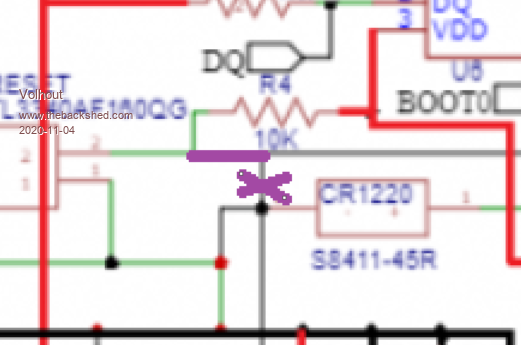

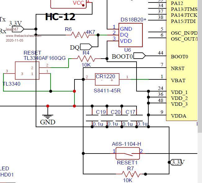

Posts: 3879
Posted: 03:52pm 04 Nov 2020

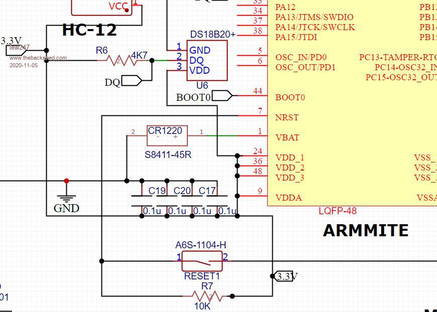

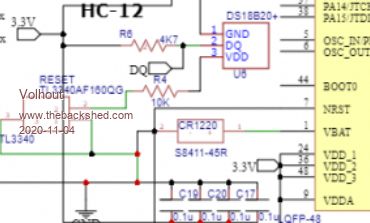

As I read it, NRST is connected directly to 0V, and also, through a 10K resistor, to 3V3. Are you sure you want the link to the right of GND connecting up to a line which goes to the left of CR1220 and on to NRST?
Something seems wrong there. Actually, as Volhout has it, the dot at "2" left of the CR1220 should not be there. (But then I'm not sure how the TL3340 should be connected.)
Edited 2020-11-05 01:54 by lizby
Posts: 6116
Posted: 04:09pm 04 Nov 2020
The only source I found for TL3340 is a mechanical push button switch.
10k pullup to 3.3V
Pushbuttonswitch to ground
That should do it for reset.

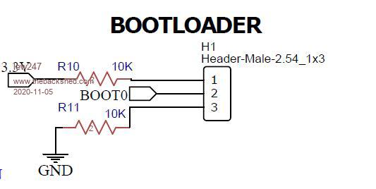

The other switch was originally connected to BOOT0 (probably a slide switch)
Now it is also connected to NRST (if I understand the intention of the schematics right). So there are 2 reset switches.
The BOOT0 now goes to a jumper. That may be better anyway.
So one of the switches can be removed.
And NRST must not be tied to ground directly (the dot lizby refers to).
lew247
This schematic look a bit confusing, that is why it may be causing so much trouble to get it right. Maybe next time, take a bigger sheet of paper (you can select that when you start a sheet) and position the parts a bit more spacious, so you can draw lines with minimal corners, and not crossing parts (the wire over the reset switch).
It is also possible to work with labels (i.e. 3V3 and GND), so all the black and red wired are not needed to be visible, and are connected in the background. Like you did with the BOOT0.

I'm such an idiot
I forgot to take the original switch out when I changed it to a jumper
Yes it was a pushbutton
Hopefully this should be better
Schematic_New1.pdf
EDIT: realised I had a mistake on the backup battery, corrected now

Posts: 3879
Posted: 06:01pm 04 Nov 2020

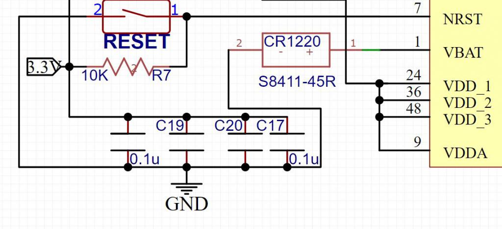

A couple of relatively simple changes could make the bottom left clearer. First move RESET1 up to the left of NRST and mirror it left to right so that pin 1 goes directly into NRST and pin 2 drops to the GND which is now directly below it.
Then mirror the 3 capacitors, C19, C20, C17 top to bottom and adjust the GND line. This will produce a more normal layout with the + voltage higher in the drawing and the GND lower.
Edited 2020-11-05 04:02 by lizby

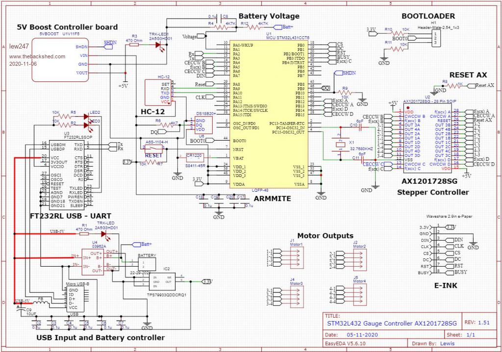

lew247

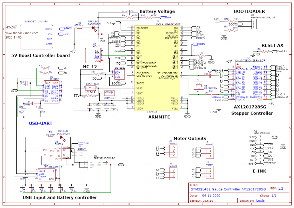

Joined: 23/12/2015
Posts: 1709
Posted: 06:28pm 04 Nov 2020
Hopefully this is slightly better
I've also added battery voltage monitoring and E-Ink to display the battery voltage
1.pdf
Edited 2020-11-05 04:48 by lew247
Posts: 3879
Posted: 08:08pm 04 Nov 2020
The top of your caps, C19, C20, C17 should connect to 3V3, and the 0V side of the CR1220 should connect to GND, not the plus side of those caps.
All the VDDs, including on the DS18B20, should connect to 3V3.
Edited 2020-11-05 06:11 by lizby
lew247
Joined: 23/12/2015
Posts: 1709
Posted: 08:15pm 04 Nov 2020
I never spotted that one, I love how helpful this forum is and everyone on it.

Posts: 3879
Posted: 08:17pm 04 Nov 2020
Not quite enough shown to see if you caught my edit--all the VDDs, including on the DS18B20, need to connect to 3V3.
