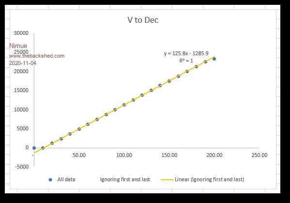

I have a device that accepts volts and squirts out two bytes of data shown below which represent the volts. I sent some accurate volt tests into it and got the following.
How are they getting those numbers from the volts and vice versa?
I have played around with various highbyte and low byte ideas and can get near but not near enough. Multiplying the first byte, adding the second etc etc.
I can get near at 50V but then it's wildly out at others..

If we can't find the formula/logic they are using perhaps it is a look up table and i could plot these points on a graph to reproduce it in excel?
THere could be a flag bit in the data when it goes to 170V and above.. That errant 2 on the end maybe!
The data it outputs is unlikely to be super accurate but it would certainly be within a couple of volts.
In the past in a similar device the data was in a single byte which was doubled to give the voltage. So $32 = 50 decimal = 100V
This is more recent and probably more accurate.
Grateful for any ideas or thoughts?  Thanks

Forgive me if I'm missing the point.. but if I convert Hex to Dec and plot I get:
Ignoring the first and last points as they look definitely non linear (clipping at the highest voltage) --- you get a perfect linear relationship between V and your Hex (now in Dec) measures...
Have I missed the point?

That's great if it's a simple linear relationship.
Sometimes you just need someone on the outside to chip in.
You can get stuck in a  loop staring at data and i'm useless with Excel.
It looks like the voltage is in the high byte and the high nibble of the low (second) byte.
The lower nibble of the low (second) byte is probably flags.
So simplifying your formula slightly and converting say 100V into the hex =
(100 x 126) - 1286 = 11314 = $2C32
Then AND $F0 to mask out the lower nibble or the low byte gives $2C30

This is another idea..
Output numbers = (Vin-10)*126 (could be more like 128 as it is then a left shift operation)
So 100V - 10 = 90 * 128 = 11520 = $2D00
We had $2C30 for 100V in the table but that's not miles off and resolution won't be much better than a volt at best.

Posts: 6606
Posted: 08:47pm 14 Nov 2020
Go back to the first answer give.
Convert the 16 bit HEX numbers into decimal.
Lets call that 'reading'
Volts = int(reading/126 + 10.8)
Ignoring the first and last readings, that is close enough for me.
I have tweaked the values to allow for rounding to whole volt values.
