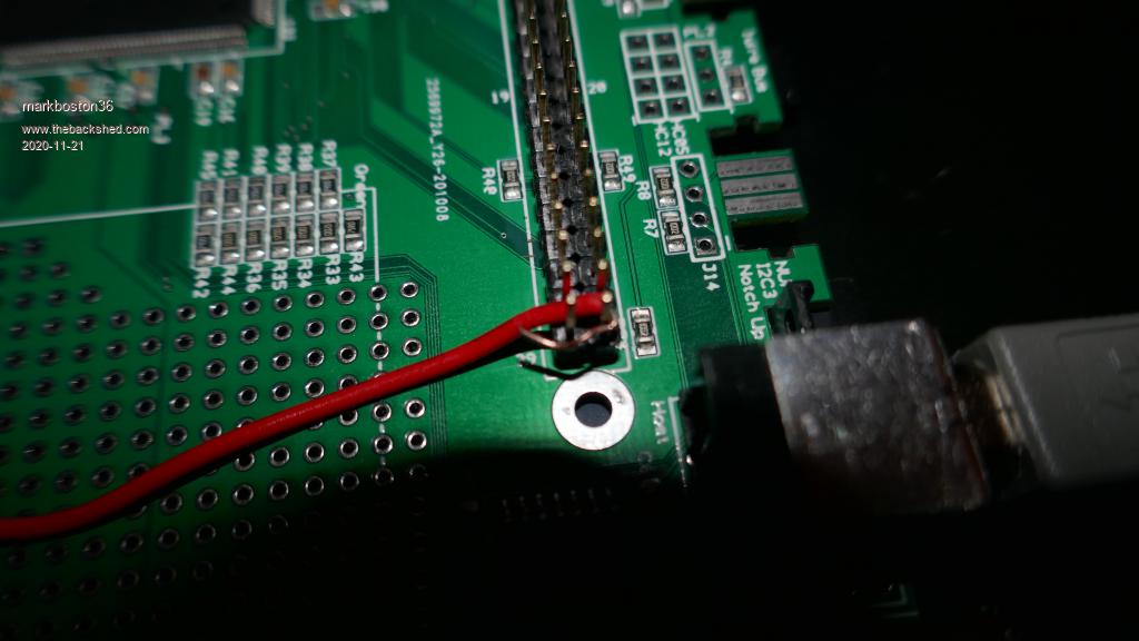

Posts: 6606
Posted: 03:43am 21 Nov 2020
Page 15 of the manual describes the procedure.
I 'think' that pin 39/40 are on the end of the connector closest to the USB ports on the retromax.
BUT I AM ONLY GOING BY A PHOTO, so check your documentation.
I 'think' I can see a 39 on the silkscreen on the circuit board.
Don't short the pins unless you are sure you have the correct pins.
The other end of the connector has 3.3V and 5V so not a good idea to short them.
I use circuit board jumpers but the blade of a screwdriver will do the job.

im using it over tty because i don't have a usb a cable it comes tomorrow.
tried grounding didn't work. it seems to be stuck on something im not getting any responce.
Posts: 6606
Posted: 06:09am 21 Nov 2020
  markboston36 said  im using it over tty because i don't have a usb a cable it comes tomorrow.
IF grounding pin 40 while you turn it on didn't do anything, you do have to update the firmware.

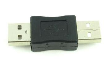

Posts: 2981
Posted: 08:26am 22 Nov 2020
Hi Mark, All,
It is SUPER easy to make a USB A-A cable,
Just find two similar cables and cut them in half and join the 4 wires one to one,
ie
BLACK to BLACK
RED to RED
WHITE to WHITE
GREEN to GREEN
You probably don’t even have to solder the wires, although that would be my recommendation, just twist them together and insulate with tape.
It’s only used for 18s to flash then put away till the next time.
Posts: 3879
Posted: 12:45pm 22 Nov 2020
Won't help immediately, but I use these:
https://www.ebay.com/itm/New-2-Pack-USB-2-0-A-Male-to-USB-A-Male-Adapter-Converter-Extender-Coupler/293482015491
