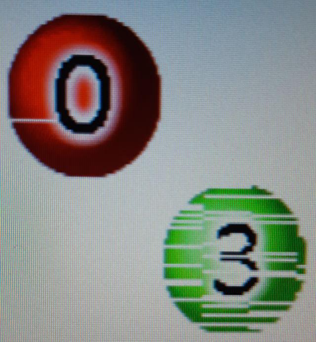

I've been chasing a sprite drawing problem in mode 1,16 for recent firmware.
Here is minimal program that shows the problem on my CMM2 (400 MHz Waveshare)
Sprites are drawn with what appear to be 16 pixel horizontal strips missing/transparent. The strange thing is, the missing parts slowly reappear when other areas of the screen are drawn.
When I save the screen image, the resulting BMP is perfect: no glitches.

Posts: 11873
Posted: 08:17pm 05 Dec 2020
  Quote  Sprites are drawn with what appear to be 16 pixel horizontal strips missing/transparent. The strange thing is, the missing parts slowly reappear when other areas of the screen are drawn.
Fixed in V5.06.00RC2 - just posted

Characterizing the MOD file issue that has been causing me some grief.
My asteroids clone Rocks in Space uses samples in a mod file for sound effects. For this to work, the mod file has to actually be 'playing'. So I created a mod file with the samples, and a single blank pattern.
"play modfile filename$" works great - silence except when I "play modsample ..."
Recent firmware versions broke Rocks in Space, with a system hang at "play modfile". I've been experimenting and discovered the following different fixes:
changing to "play modfile filename$, 8000" seems to fix it,
adding "pause 10" right after "play modfile filename$" seems to fix it,
turning on trace seems to fix it.
The code around the "play modfile filename$" command is:
' Sounds: sounds are stored in a custom MOD file.
' This MOD file contains only a single blank pattern, which the CMM2 will
' dutifully play as silence. However, the individual samples can be played
' on demand while the MOD file is silently playing.
play modfile "RISsound.mod" ', 8000  ' adding ,8000 fixes problem
'trace on  ' fixes problem
pause 10  ' fixes problem
'pause 1   ' too short, doesn't fix
hurn = 1    ' hurry up sound number 1 to start
hurs = 1000
settick hurs + 175,HurryUp
'end   ' program doesn't hang
' Vector Font 16 x 20
' ascii 32 to 128  - used for number display, ought to simplify the font
load font "Vector16x20.fnt"
It could be that disk access too quickly after the 'play modfile' is the cause of my problem. The extra hint is that the SD access LED is on when the system hangs.
