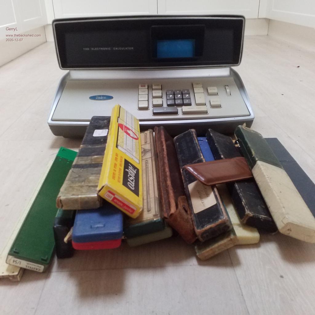

this is great Jim, below is pix of my 20+ slide rules that I rediscovered hiding in my shed that I had all but forgotten about. In the background is the culprit that started their demise, a Friden 130 calculator. The 130 was the first solid state desk top calculator that was released in mid 1960's and takes pride of place in my electronic calculator collection.  It used discrete components and an acoustic delay line for the memory plus a CRT for the display, amazing for its time.
Gerry

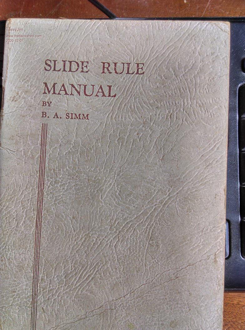

Posts: 6606
Posted: 04:19am 07 Dec 2020
For those who insist on a printed manual:
No date unfortunately but the price was 2 shillings and 6 pence.
Update to my code with all the flickering gone.
I now print to page 1 for everything and do a PAGE COPY 1 TO 0 ,B
I changed a few sequences and now very happy with the results.
