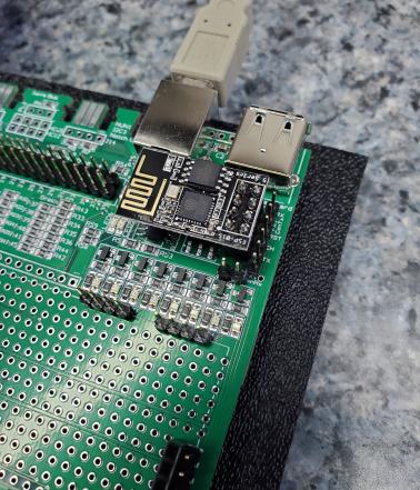

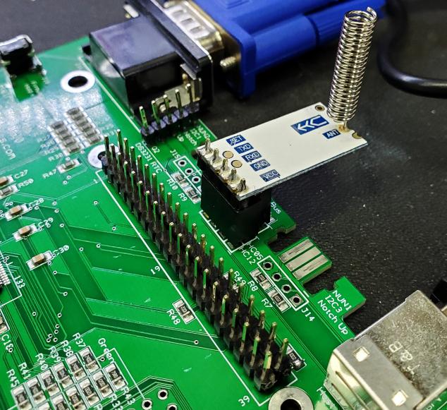

CircuitGizmos
Joined: 08/09/2011
Posts: 1427
Posted: 07:56pm 13 Dec 2020
I've been using the console for transfers using an HC-12 wireless module.
The same can be done with an ESP8266-01 programmed for serial transfer.
